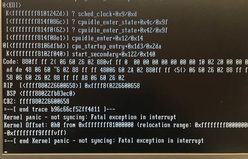

Help! Came home the other day to the unraid not responding. Turned on the monitor hooked up the the unraid computer and it was at Tower with a few characters below it and wasn't responsive to any keyboard inputs.
Turn off the computer and as it was restarting it stalled for a minute on one of the boot screens for the computer hardware, I believe it was a controller card that houses the sata ports I'm using. It was showing errors, but I didn't have time to catch it as it continued to the next screen. When I was able to get the tower screen in my browser it showed the parity and one other disc not found. I restarted the system from the menu. It came back up just fine and I started it to run the parity check. It ran for 2 hours before I went to bed without any errors.
When I woke up this morning it wasn't working again. I turned on the monitor for the unraid and got this screen. Any help would be appreciated. I haven't changed anything on the unraid in years.
