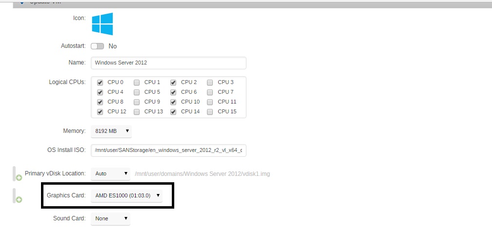

i need to make my one of my Vms to show on my Monitor ,and this Server have only Graphic Card : AMD ES1000(01:03.0)

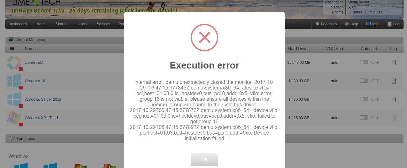

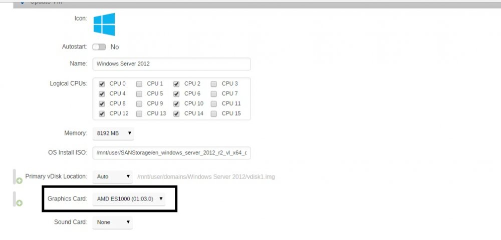

when i choose it instead of VNC , igot this error ,so is there a solution for my problem.
here is the error when i start my VM
internal error: qemu unexpectedly closed the monitor: 2017-10-29T06:47:15.377845Z qemu-system-x86_64: -device vfio-pci,host=01:03.0,id=hostdev0,bus=pci.0,addr=0x5: vfio: error, group 16 is not viable, please ensure all devices within the iommu_group are bound to their vfio bus driver.
2017-10-29T06:47:15.377877Z qemu-system-x86_64: -device vfio-pci,host=01:03.0,id=hostdev0,bus=pci.0,addr=0x5: vfio: failed to get group 16
2017-10-29T06:47:15.377892Z qemu-system-x86_64: -device vfio-pci,host=01:03.0,id=hostdev0,bus=pci.0,addr=0x5: Device initialization failed
