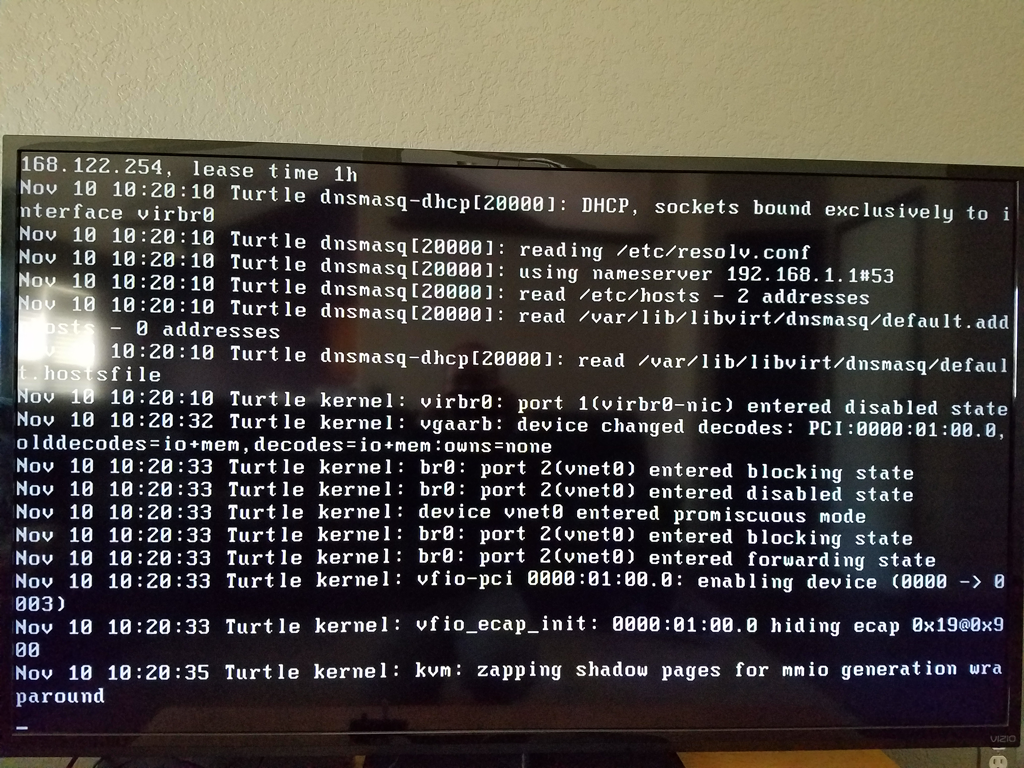

November 10, 20179 yr Author I tried to tail the syslog and took a picture, but that is the same thing that was onscreen after I shutdown the Windows 7 VM. Nothing new when I started the Windows 10 VM that locked up Unraid. I'll attach anyways. It seems to be consistent that if I start Windows 7 and then go to Windows 10 that it locks everything up. I believe I have gone from Windows 10 to Windows 7 without that happening. I can't recall if I have tried just reloading the same VM.
