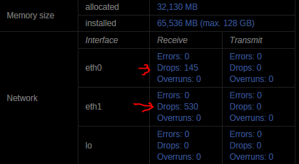

Probably related, there appears to be packets dropped on my NICs:

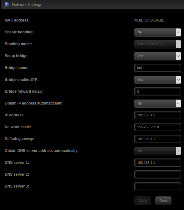

My network is set up like this:

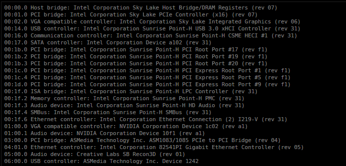

It puzzles me, as 'device [04:00.0]' does not appear at all under 'System devices':
I find that a SCSI device have a somewhat similar address, but this isn't the same as "04:00:0", is it?:
[4:0:0:0]    disk    ATA      WDC WD30EFRX-68E 0A82  /dev/sde

05:00.0 Audio device: Creative Labs SB Recon3D (rev 01)
All was good from the get go. I used it on my original 6.1.9 build and tjen later onto my 6.3.5 build (in a new VM). Last night, after downgrading, my VM (both old and newly created) would not boot with this card passed through. After taking a closer look at the 'System devices', I noticed that the card now had been assigned into an IOMMU-group with lots of other devices:
/sys/kernel/iommu_groups/7/devices/0000:00:1b.2
/sys/kernel/iommu_groups/7/devices/0000:00:1b.3
/sys/kernel/iommu_groups/7/devices/0000:03:00.0
/sys/kernel/iommu_groups/7/devices/0000:04:01.0
/sys/kernel/iommu_groups/7/devices/0000:05:00.0
These other devices are:
00:1b.2 PCI bridge: Intel Corporation Sunrise Point-H PCI Root Port #19 (rev f1)
00:1b.3 PCI bridge: Intel Corporation Sunrise Point-H PCI Root Port #20 (rev f1)
03:00.0 PCI bridge: ASMedia Technology Inc. ASM1083/1085 PCIe to PCI Bridge (rev 04)
04:01.0 Ethernet controller: Intel Corporation 82541PI Gigabit Ethernet Controller (rev 05)
I suspect this change in IOMMU-grouping are a result of me updating the motherboard BIOS while I still was running Unraid 6.3.5, but then again; Why wouldn't this have prohibited me running my VM then, as it is now?
4. Wrong amount of memory reported
Noticed this now as I already had created this thread. Dashboard reports 65GB of memory. In reality I have 32GB. Have my downgrade magically duplicated my RAM, making my sweet box even more gnarly?:p Seriously; What is happening?

1. i've now bonded the network cards in 'active-backup mode'. Still getting some packet drops, but not experiencing any problems in stability or slow networking.

3. Tried moving my PCIEx1 sound card to another slot (PCIEx4), and now the card is not even available as a passable choice in the VM edit.
Under System devices its recognized as:
07:00.0 Audio device: Creative Labs SB Recon3D (rev 01)
It's grouped with the following devices in IOMMU-group 7:
00:1c.0 PCI bridge: Intel Corporation Sunrise Point-H PCI Express Root Port #1 (rev f1)
00:1c.4 PCI bridge: Intel Corporation Sunrise Point-H PCI Express Root Port #5 (rev f1)
06:00.0 USB controller: ASMedia Technology Inc. Device 1242
I've currently disabled the PCI ACS Override. To my great joy my VM is still working with passthrough on the GPU and other needed peripherals. Think I'll keep this setup for now.

4. For some weird reason "Installed memory" is still reported wrongly on the dashboard.
