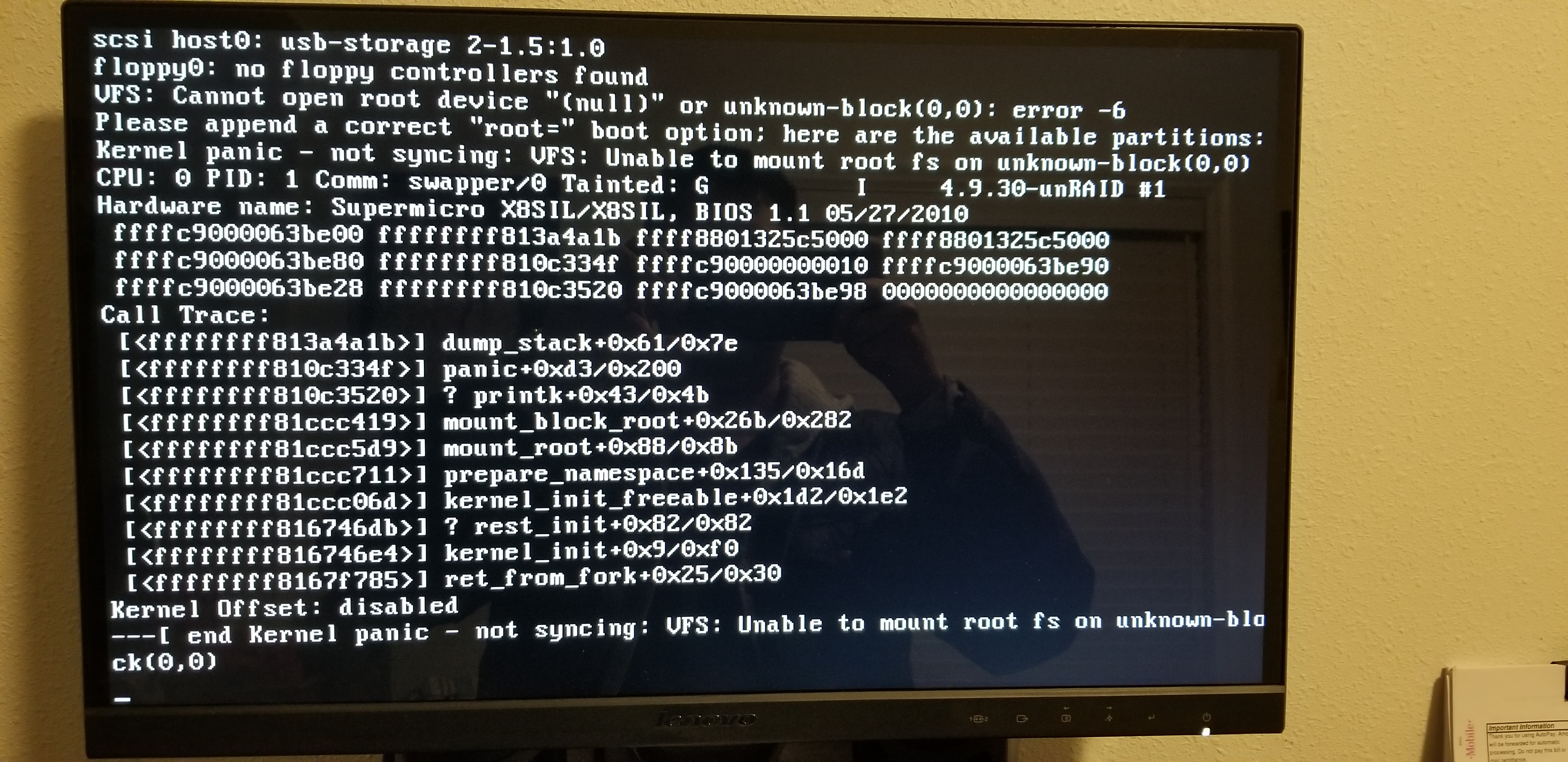

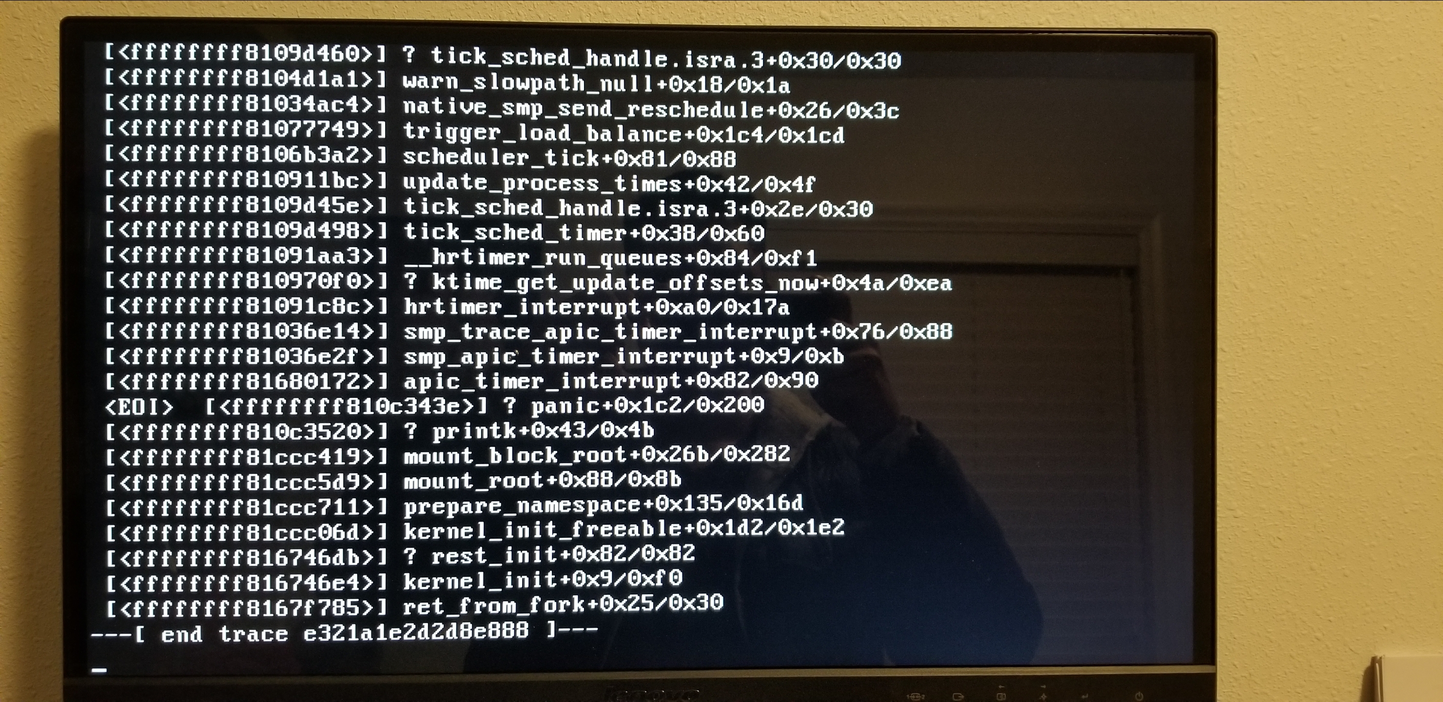

Here are couple of screenshot. My server is not booting all the way.
Have you connected the USB drive to another computer and checked it for corruption?
And while you do that - remember to make a backup of the config directory.
Thank you. I will try to do what you recommended. Thank you so much for taking time helping me with my problem. I will report back soon.
Have a happy New year!
Thank you pwm. I reformatted my USB; reinstalled fresh Unraid (6.3.5); copy the config folder backup. So far it's working great. Thank you for your help. Cheers!
