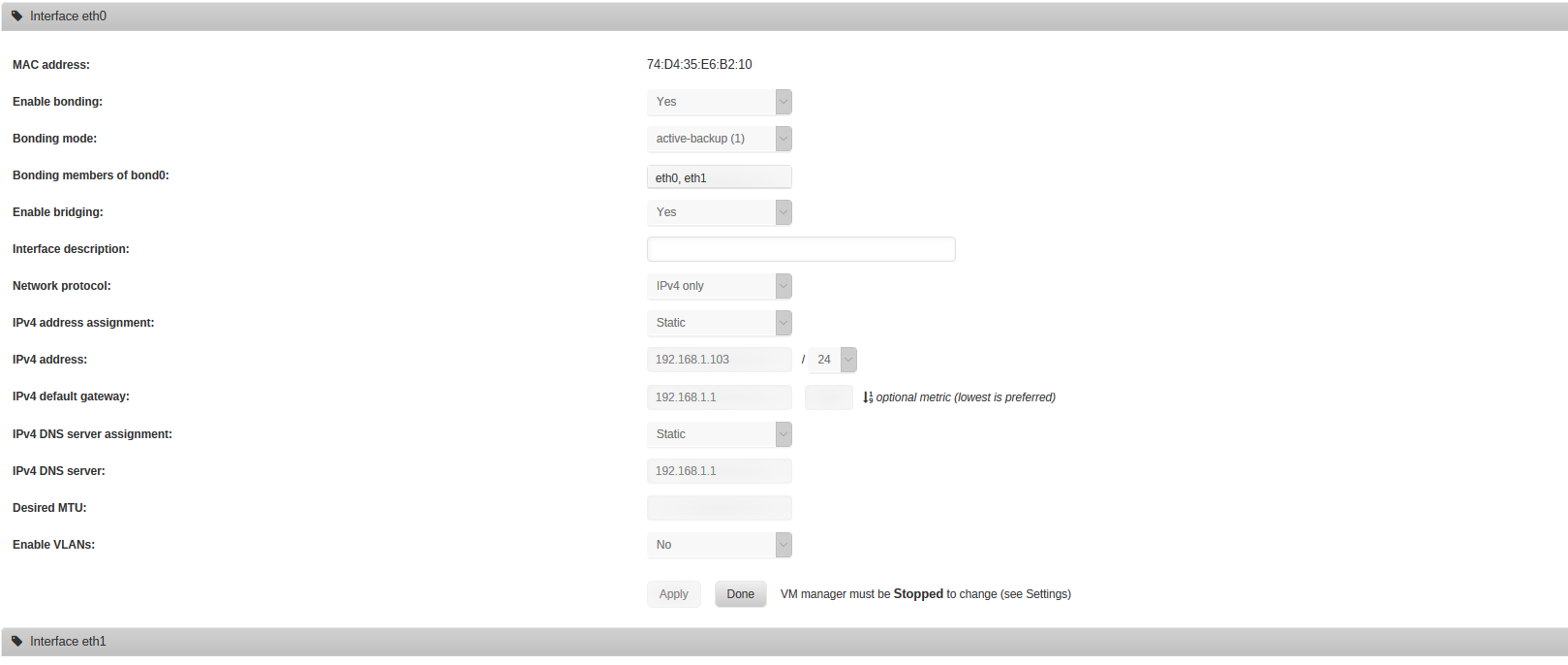

Hey everyone so i was wondering if anyone could help... I've been on this for 5 hours now and still can't figure it out.
My VM's no longer get access to the network, br0 is set within my vm's bridge is enabled and every time i check the VM's they are just on loopback (with ifconfig)
If i look in my router i don't even see them in the dhcp getting an ip... any help would be great!
I've even gone as far as completely re-doing my whole entire unraid setup with a new USB, minus keeping the drive files and share files...

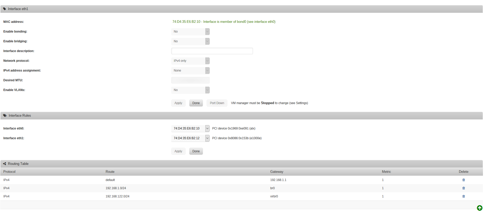

same issue with VyOS; even tried to pfsense with the same issue.  Downgrading to 6.3.5 at least has them showing up, however I have 2 servers 1 on 6.4.0 and not the "vswitch" on 6.3.5.  Something is off now as latency is terrible w/huge amounts of dropped packets.  This setup was working perfectly fine for my 10GB network w/both machines on 6.3.5; what gives?
