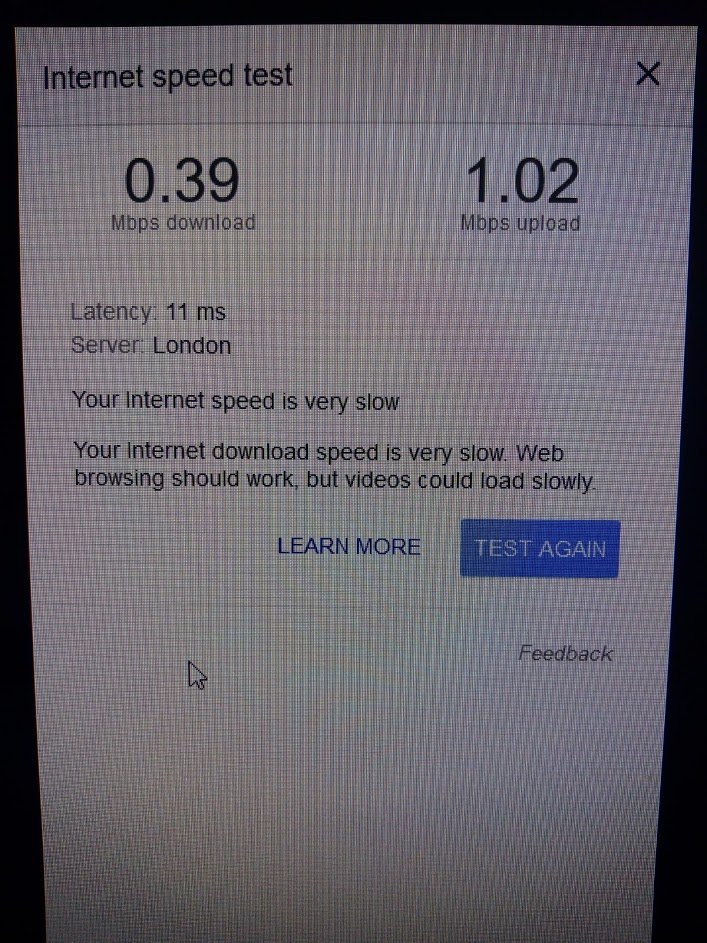

1.) I have fixed the Internet problem by assigning a static IP to the server from the router.
Hello, I have spent all weekend so far setting this up, from Friday midday until now, I have had many problems and have eventually overcome these with help to the forums and even a rapid reply from "Eric Schultz", My current problems are as detailed below.

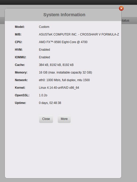

System Specs.

1.) The Internet is running slow. I normally get 24mb [Solved]
I get a 503 error when trying to access Github.com via the Unraid server, but on my VM I can access it.

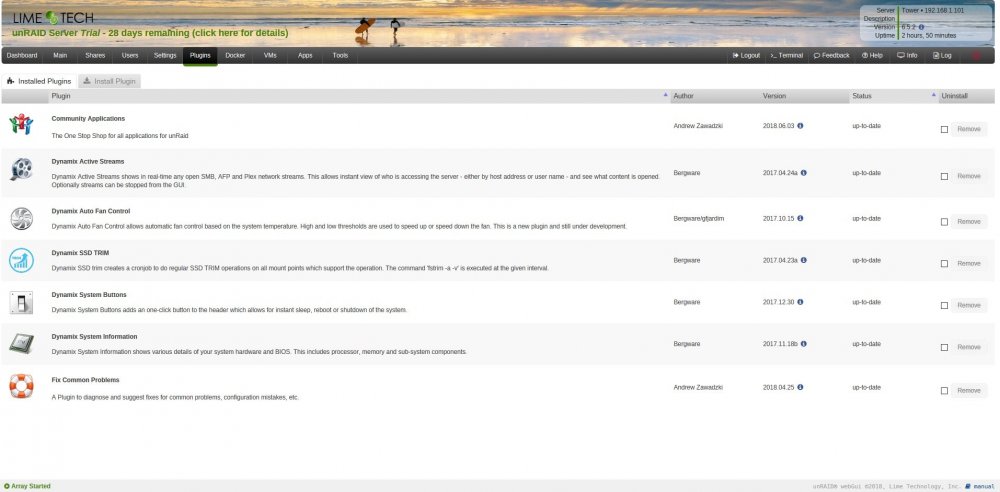

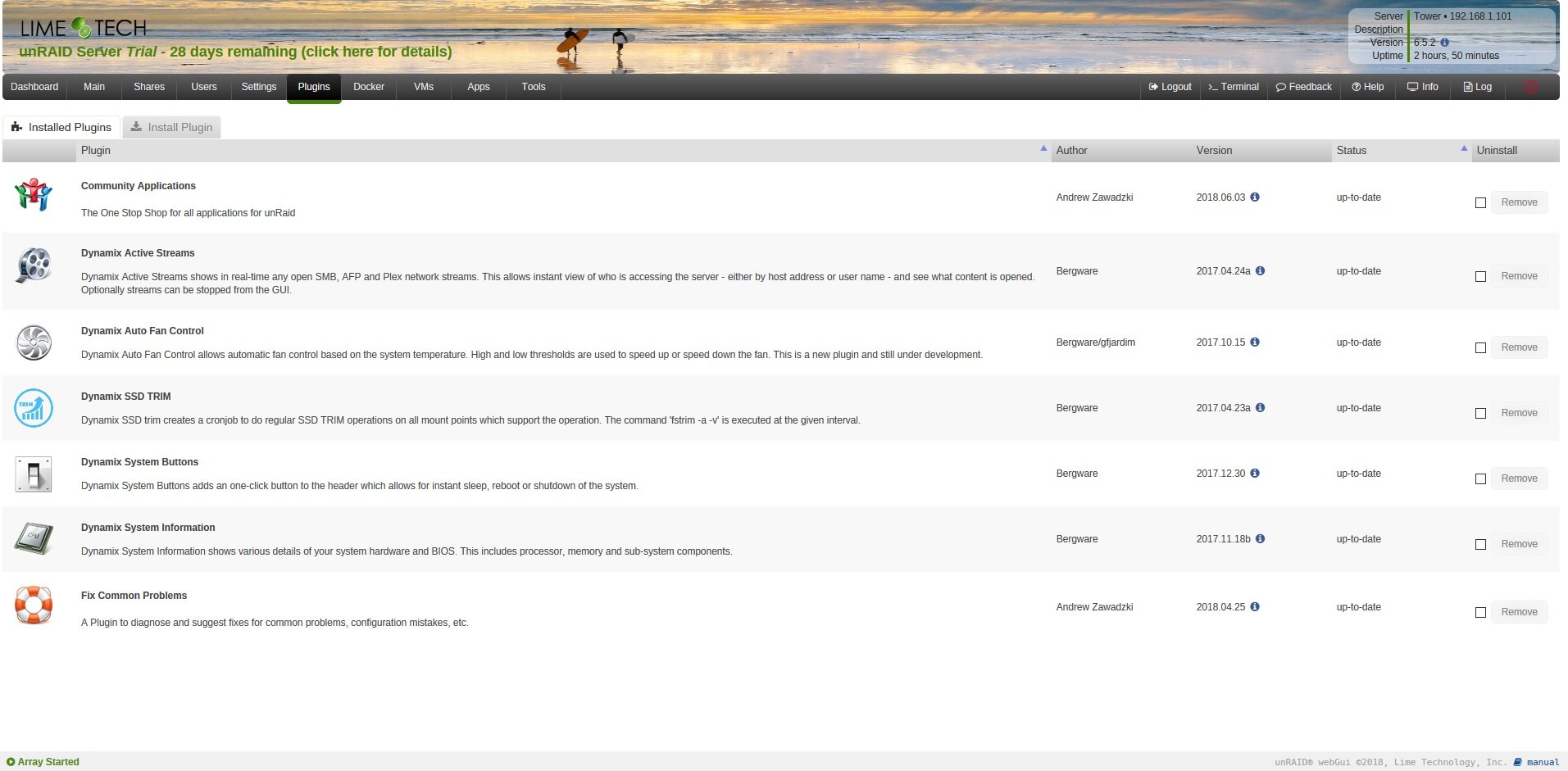

2.) Plugins install with the exception of Unassigned Devices, I get this error.
plugin: installing: https://github.com/dlandon/unassigned.devices/raw/master/unassigned.devices.plg
plugin: downloading https://github.com/dlandon/unassigned.devices/raw/master/unassigned.devices.plg
plugin: downloading: https://github.com/dlandon/unassigned.devices/raw/master/unassigned.devices.plg ... failed (Network failure)
plugin: wget: https://github.com/dlandon/unassigned.devices/raw/master/unassigned.devices.plg download failure (Network failure)

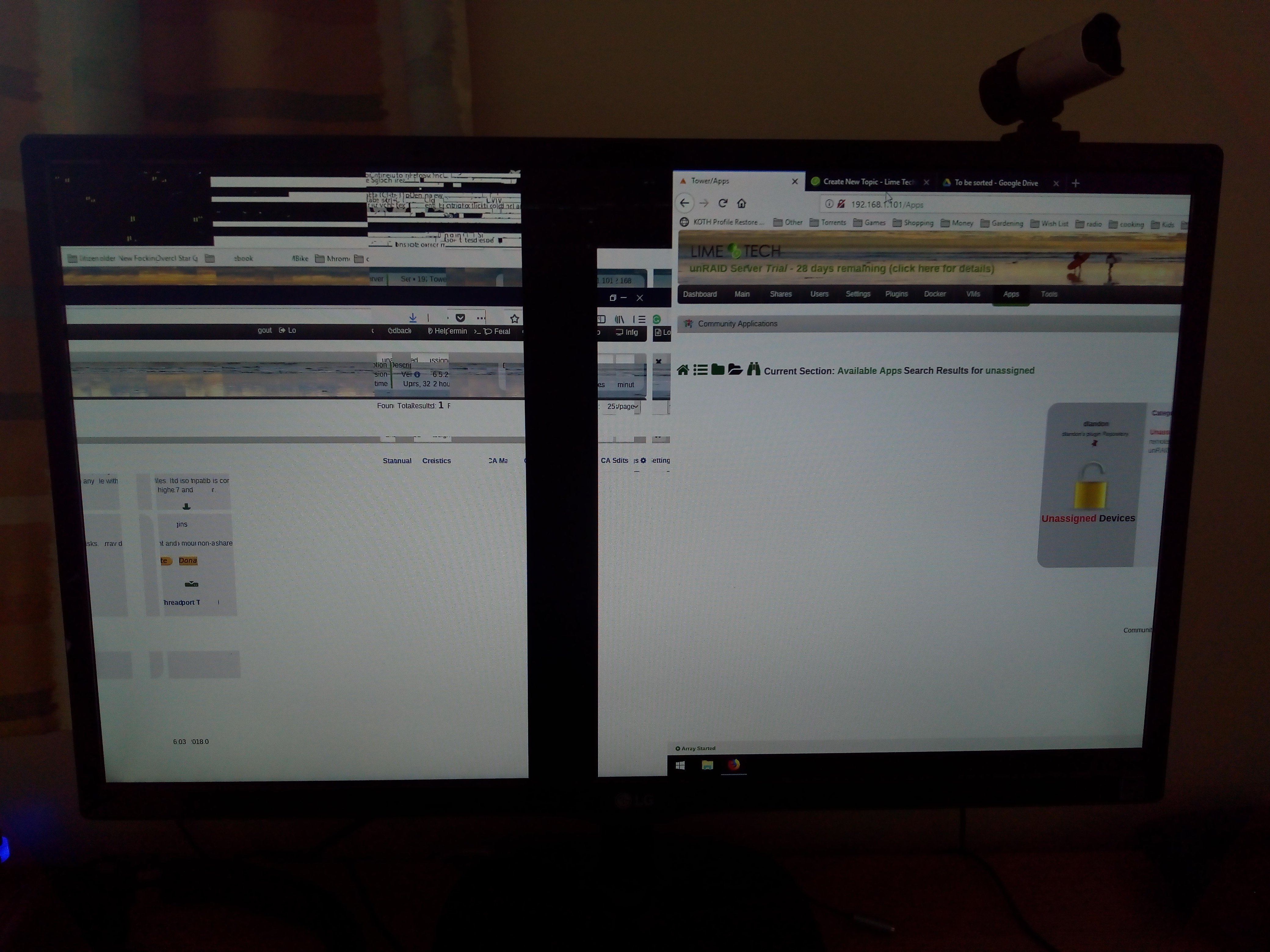

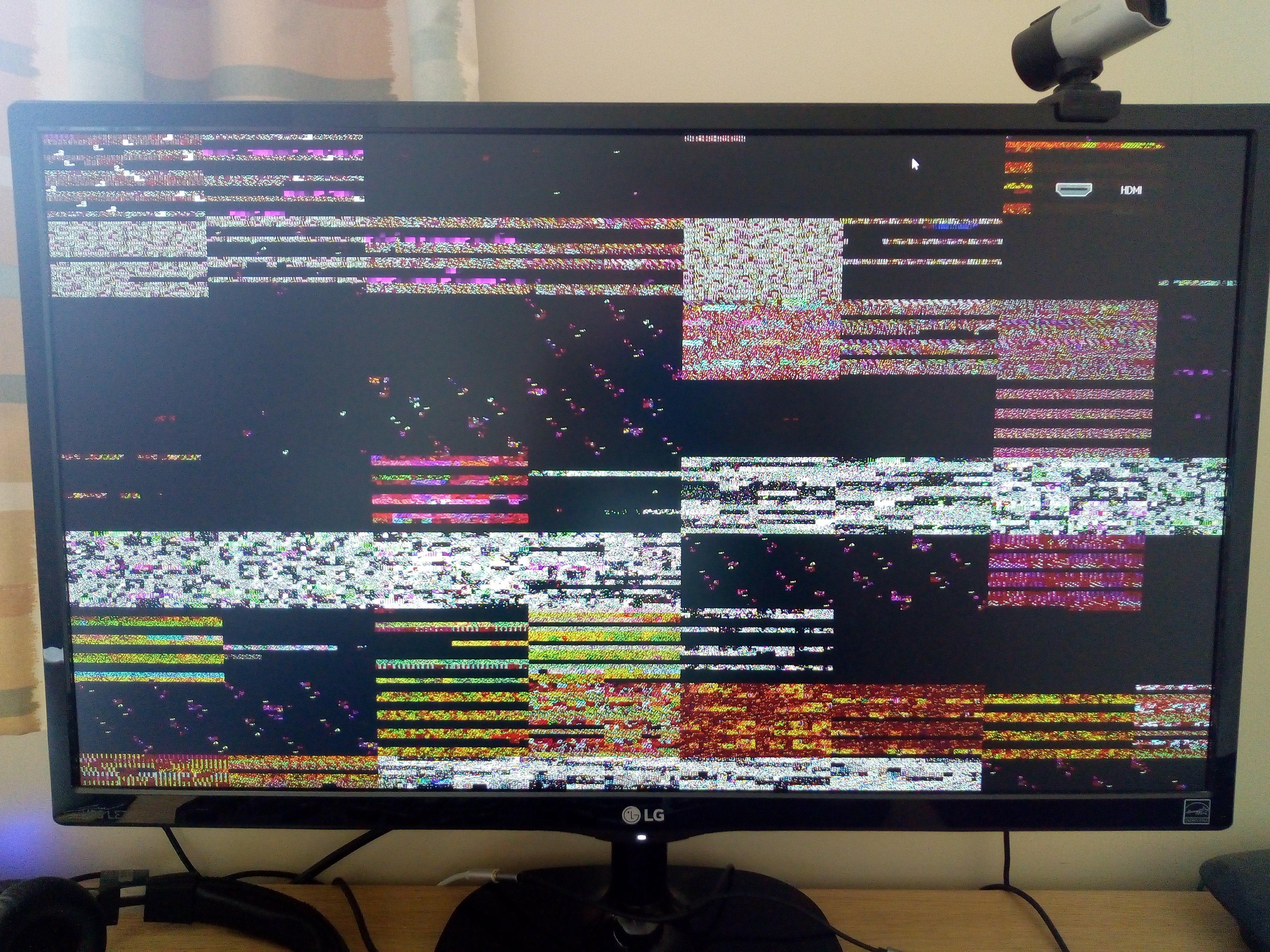

3.) GPU / Graphics Artifacts / Screen tearing.
This happens randomly, the same thing every time, can happen at startup (loading windows logo) then disappears once on the desktop loads (maybe drivers?)
IMG_20180610_162944583.thumb.jpg.19f9df351b710c2118445aad9faddc2b.jpgIMG_20180610_162932091.thumb.jpg.aee274c3a8bf52cda6527a012f61f42f.jpg
and blank screen

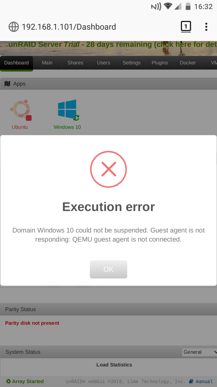

When trying to remote hibernate the VM I get this
