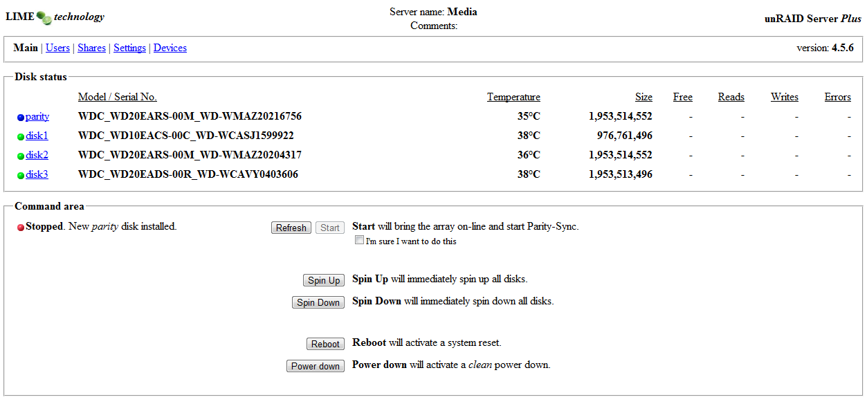

That's what I tried but it won't.
I did:
Devices
Unassigned (on parity)
Main  -  I get the attached screen.  If I tick "I'm sure I want to do this" the start button remains greyed out.
I did:
Devices
That screen shot does not show parity un-assigned.  In any case you can type:
initconfig
Respond to the prompt with
Yes  (capital "Y" lower case "es")
then refresh the main screen and start the array.  It will then begin a complete parity calculation.
