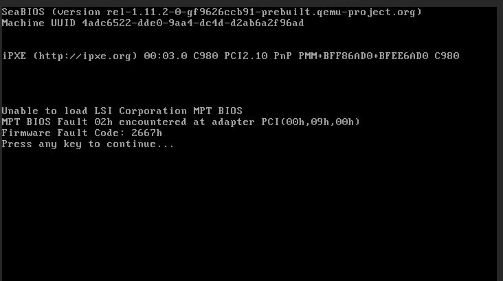

September 27, 20188 yr <<<<<<<<<<EDIT!!!!>>>>>>>>>> Okay.. apparently I got ahead of myself here. I figured it out! by using OMVF and i440fx-3.0 I was able to get freenas to install and recognize the card. It booted without error. Apparently I had not tried this config before and I thought I had. I had originally tried OMVF with Q35, and It would boot, but i had no network device (defeats the purpose of a NAS...). Then I tried SeaBIOS with i440fx-3.0 and i got that error. I thought i had tried OMVF and i44fx-3.0 but I was apparently mistaken. So please, ignore my help request, but if you want to keep this so someone else may be helped by it! Feel free! ---------------------------------------------------------------------------------------------------------------------------- Hey guys, I've tried searching and reading as much as I could to try and understand what I'm doing wrong here, but I can't seem to get my LSI 9211 8i SAS card working right. I am exceptionally new to unraid, pretty much fumbling around right now. If anyone could point me in the right direction, I would appreciate it! My goal here, is to have my server host several VMs. pfSense Freenas 11.1U6 Win7 VM Win10 VM LibreElecVM I have the windows 7, 10, and libreElec VMs working properly, with GPU passthrough. (not to be run at the same time...) I'm still working on figuring out the pfSense and Freenas VMs though. When I was on unraid 6.5.3, I couldn't start the VM, it would give me a DMA mapping error and crash. Upgrading to 6.6.0 allowed me to actually boot the VM. The card works perfectly fine and recognizes drives attached to it when I allow unraid to access the controller directly The card is on p20 firmware in IT mode (I purchased it this way) The card is in its own IOMMU group IOMMU group 13: [1000:0072] 05:00.0 Serial Attached SCSI controller: LSI Logic / Symbios Logic SAS2008 PCI-Express Fusion-MPT SAS-2 [Falcon] (rev 03) The card is blacklisted using vfio-pci.ids in the syslinux.cfg. 10de is my GPU and the 1000:0072 entry is the LSI card. default menu.c32 menu title Lime Technology, Inc. prompt 0 timeout 50 label unRAID OS menu default kernel /bzimage append isolcpus=1-3 vfio-pci.ids=10de:1187 vfio-pci.ids=10de:0e0a vfio-pci.ids=1000:0072 initrd=/bzroot label unRAID OS GUI Mode kernel /bzimage append initrd=/bzroot,/bzroot-gui label unRAID OS Safe Mode (no plugins, no GUI) kernel /bzimage append initrd=/bzroot unraidsafemode label unRAID OS GUI Safe Mode (no plugins) kernel /bzimage append initrd=/bzroot,/bzroot-gui unraidsafemode label Memtest86+ kernel /memtest When I start the VM, I get the following error... Here is my xml file <?xml version='1.0' encoding='UTF-8'?> <domain type='kvm'> <name>FreeNAS 11</name> <uuid>4adc6522-dde0-9aa4-dc4d-d2ab6a2f96ad</uuid> <metadata> <vmtemplate xmlns="unraid" name="FreeBSD" icon="freebsd.png" os="freebsd"/> </metadata> <memory unit='KiB'>8388608</memory> <currentMemory unit='KiB'>8388608</currentMemory> <memoryBacking> <nosharepages/> </memoryBacking> <vcpu placement='static'>1</vcpu> <cputune> <vcpupin vcpu='0' cpuset='3'/> </cputune> <os> <type arch='x86_64' machine='pc-i440fx-2.12'>hvm</type> </os> <features> <acpi/> <apic/> </features> <cpu mode='host-passthrough' check='none'> <topology sockets='1' cores='1' threads='1'/> </cpu> <clock offset='utc'> <timer name='rtc' tickpolicy='catchup'/> <timer name='pit' tickpolicy='delay'/> <timer name='hpet' present='no'/> </clock> <on_poweroff>destroy</on_poweroff> <on_reboot>restart</on_reboot> <on_crash>restart</on_crash> <devices> <emulator>/usr/local/sbin/qemu</emulator> <disk type='file' device='disk'> <driver name='qemu' type='qcow2' cache='writeback'/> <source file='/mnt/user/domains/FreeBSD/vdisk1.img'/> <target dev='hdc' bus='virtio'/> <boot order='1'/> <address type='pci' domain='0x0000' bus='0x00' slot='0x06' function='0x0'/> </disk> <controller type='usb' index='0' model='ich9-ehci1'> <address type='pci' domain='0x0000' bus='0x00' slot='0x07' function='0x7'/> </controller> <controller type='usb' index='0' model='ich9-uhci1'> <master startport='0'/> <address type='pci' domain='0x0000' bus='0x00' slot='0x07' function='0x0' multifunction='on'/> </controller> <controller type='usb' index='0' model='ich9-uhci2'> <master startport='2'/> <address type='pci' domain='0x0000' bus='0x00' slot='0x07' function='0x1'/> </controller> <controller type='usb' index='0' model='ich9-uhci3'> <master startport='4'/> <address type='pci' domain='0x0000' bus='0x00' slot='0x07' function='0x2'/> </controller> <controller type='pci' index='0' model='pci-root'/> <controller type='sata' index='0'> <address type='pci' domain='0x0000' bus='0x00' slot='0x04' function='0x0'/> </controller> <controller type='virtio-serial' index='0'> <address type='pci' domain='0x0000' bus='0x00' slot='0x05' function='0x0'/> </controller> <controller type='ide' index='0'> <address type='pci' domain='0x0000' bus='0x00' slot='0x01' function='0x1'/> </controller> <interface type='bridge'> <mac address='52:54:00:93:bc:dd'/> <source bridge='br0'/> <model type='virtio'/> <address type='pci' domain='0x0000' bus='0x00' slot='0x03' function='0x0'/> </interface> <serial type='pty'> <target type='isa-serial' port='0'> <model name='isa-serial'/> </target> </serial> <console type='pty'> <target type='serial' port='0'/> </console> <channel type='unix'> <target type='virtio' name='org.qemu.guest_agent.0'/> <address type='virtio-serial' controller='0' bus='0' port='1'/> </channel> <input type='tablet' bus='usb'> <address type='usb' bus='0' port='1'/> </input> <input type='mouse' bus='ps2'/> <input type='keyboard' bus='ps2'/> <graphics type='vnc' port='-1' autoport='yes' websocket='-1' listen='0.0.0.0' keymap='en-us'> <listen type='address' address='0.0.0.0'/> </graphics> <video> <model type='qxl' ram='65536' vram='65536' vgamem='16384' heads='1' primary='yes'/> <address type='pci' domain='0x0000' bus='0x00' slot='0x02' function='0x0'/> </video> <hostdev mode='subsystem' type='pci' managed='yes'> <driver name='vfio'/> <source> <address domain='0x0000' bus='0x05' slot='0x00' function='0x0'/> </source> <address type='pci' domain='0x0000' bus='0x00' slot='0x09' function='0x0'/> </hostdev> <memballoon model='virtio'> <address type='pci' domain='0x0000' bus='0x00' slot='0x08' function='0x0'/> </memballoon> </devices> </domain> I've looked up the error on google, but what i've found so far doesn't really help me on unraid. either that, or i'm not understanding it. Thanks for your help and time! Edited September 27, 20188 yr by crystawth
