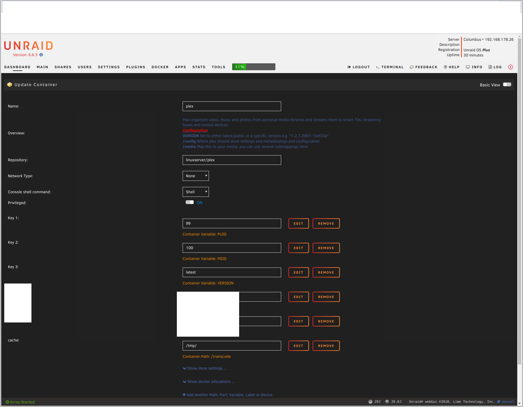

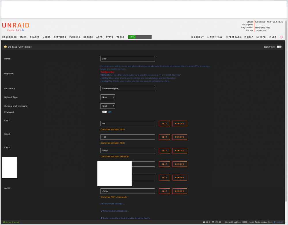

Whenever I start my Unraid System (sometimes you need to reboot) the Dockers can't start automatically.

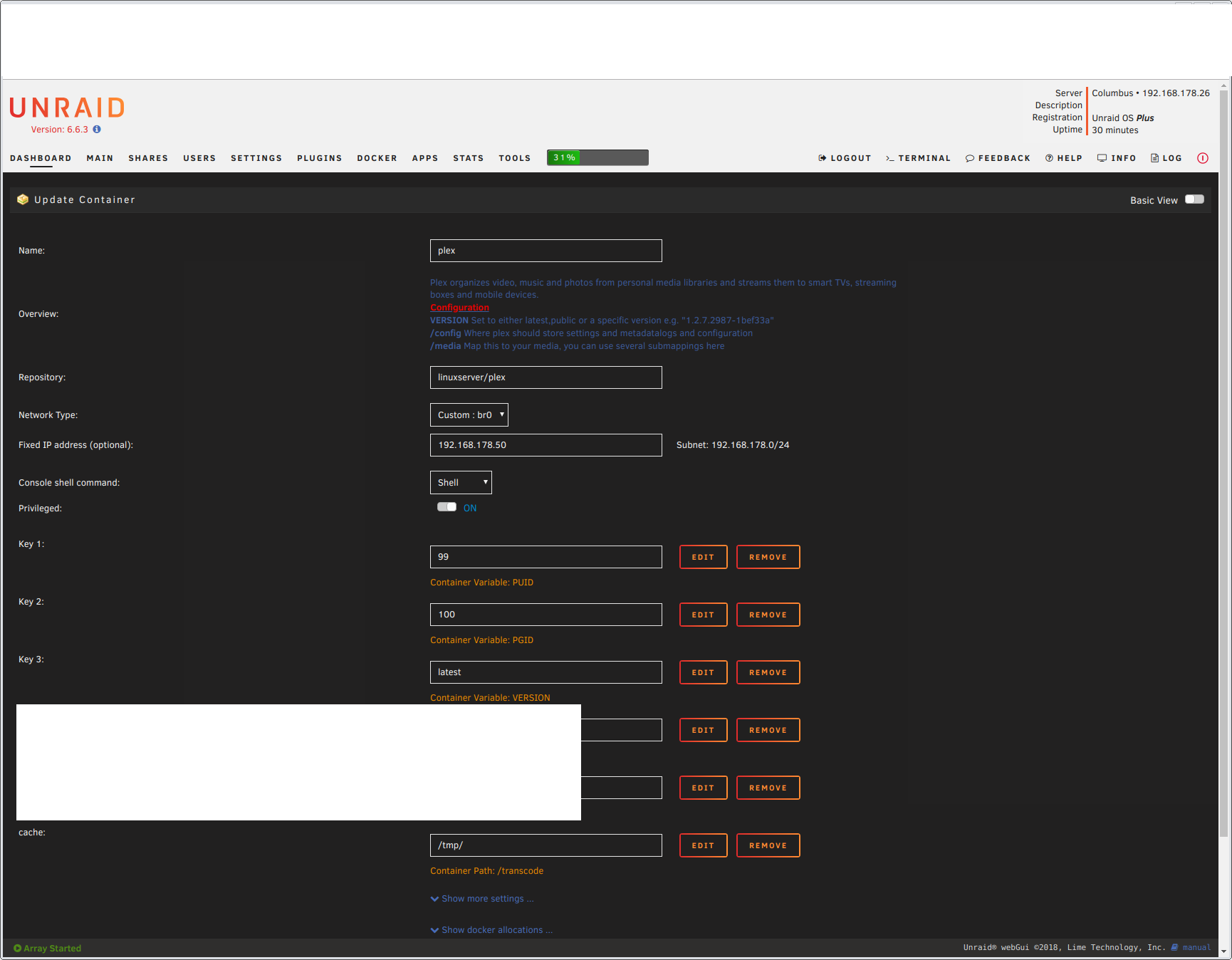

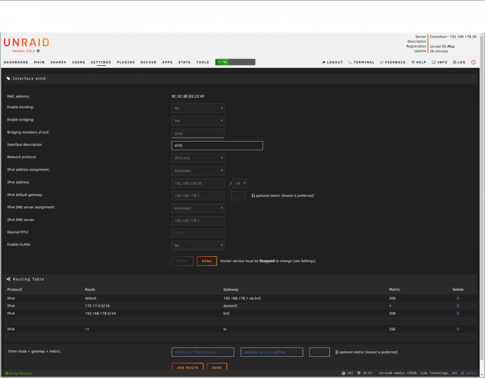

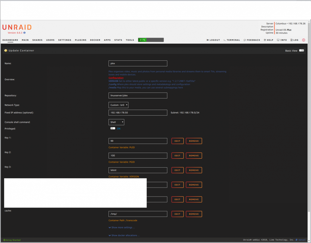

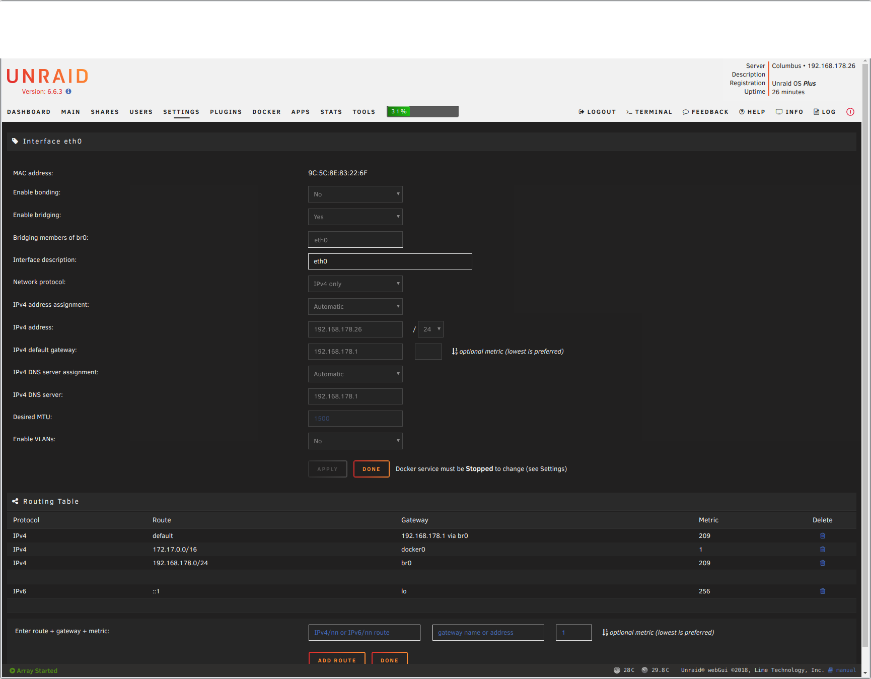

So I went into edit Mode and I saw that the `Network Type` is set to none, instead of `br0`. Since this Interface is only missing for Docker (my VM templates still offers me to select it) I went to Settings/Docker and disabled the service and enabled it again.
I went back to edit the container and tada: network interface is already selected properly and container boots just fine.
