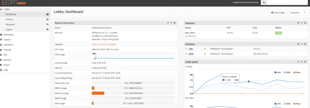

public-ip-->[ISP Modem/Router]192.168.178.1-------192.168.178.10[OPNSense Router]10.0.0.1/24----------Rest of my network (unRAID server, WIFI-AP's, Switches etc)

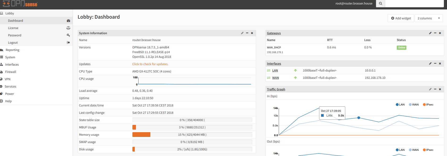

  • The OPNSense router is in the DMZ of my ISP-provided box (that I unfortunately can't put into bridge mode)

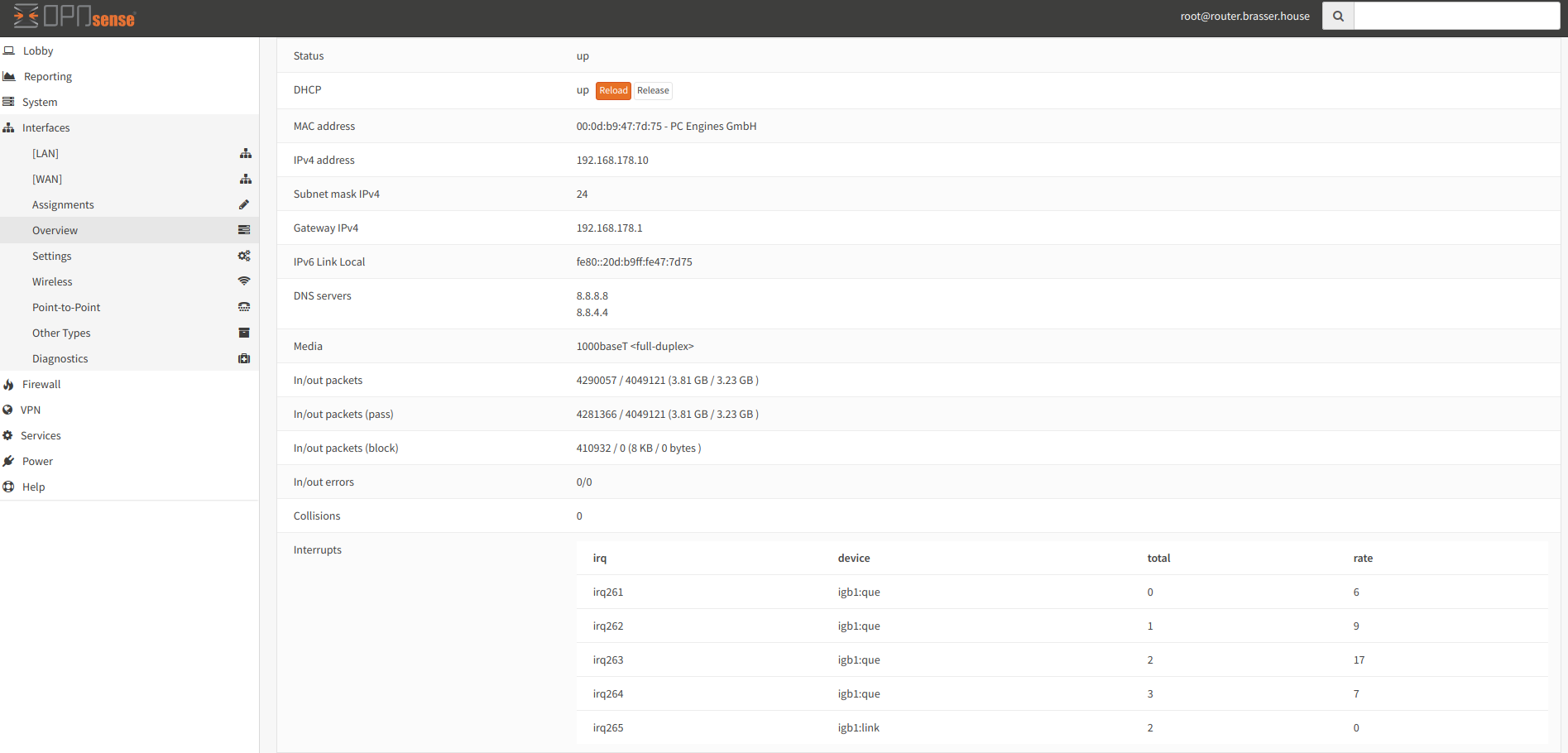

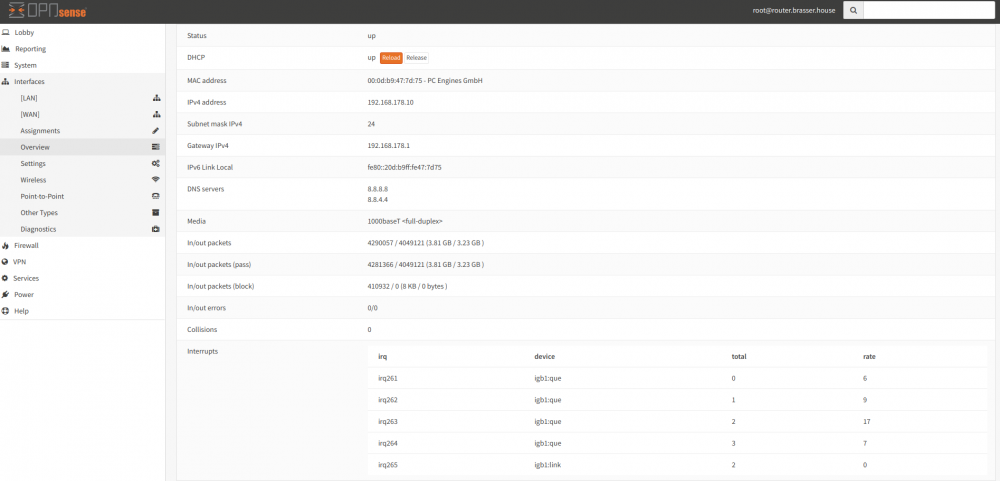

  • I have allowed private IP ranges on WAN on my OPNSense router

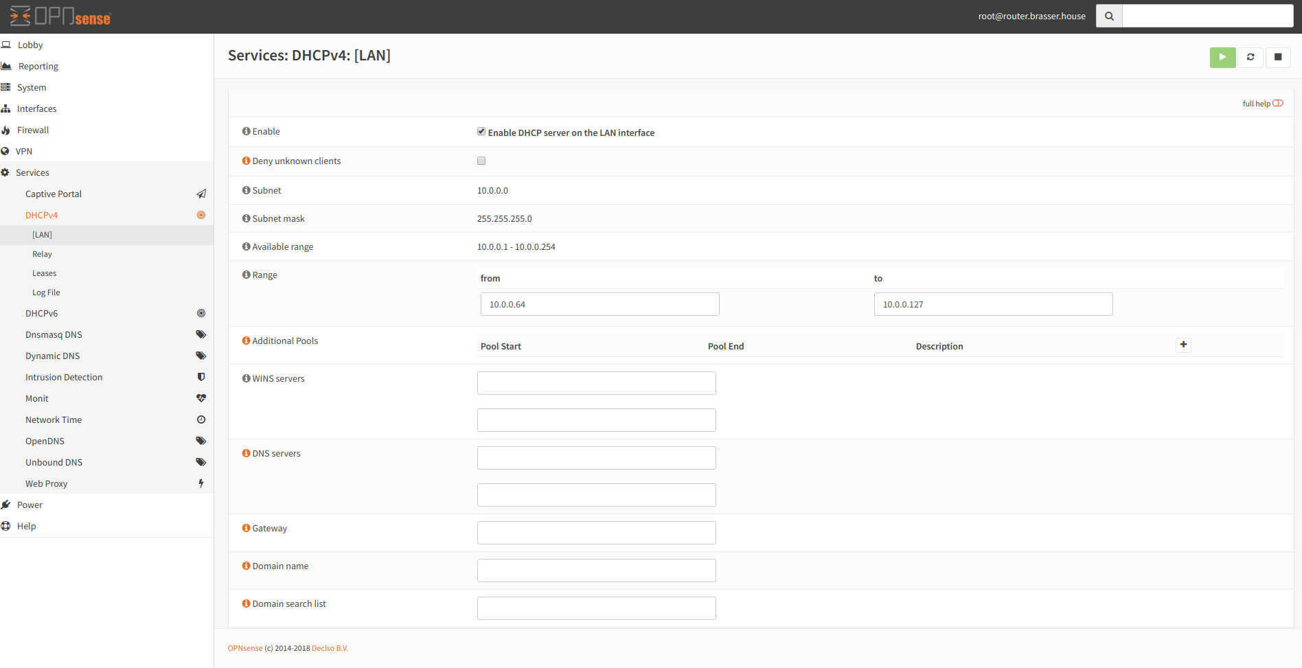

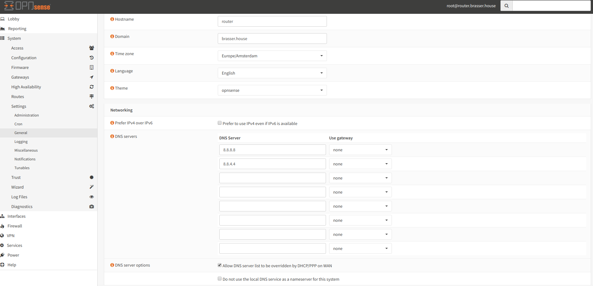

  • I have set 8.8.8.8 and 8.8.4.4 as the only DNS in the OPNSense router, this is what all clients get via the DHCP server that is running on the LAN interface.
  • I have disabled any type of DNS resolver/forwarder for now.
  • This DHCP server gives out adresses from 10.0.0.64 till 10.0.0.127

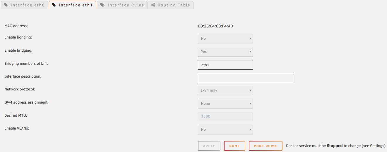

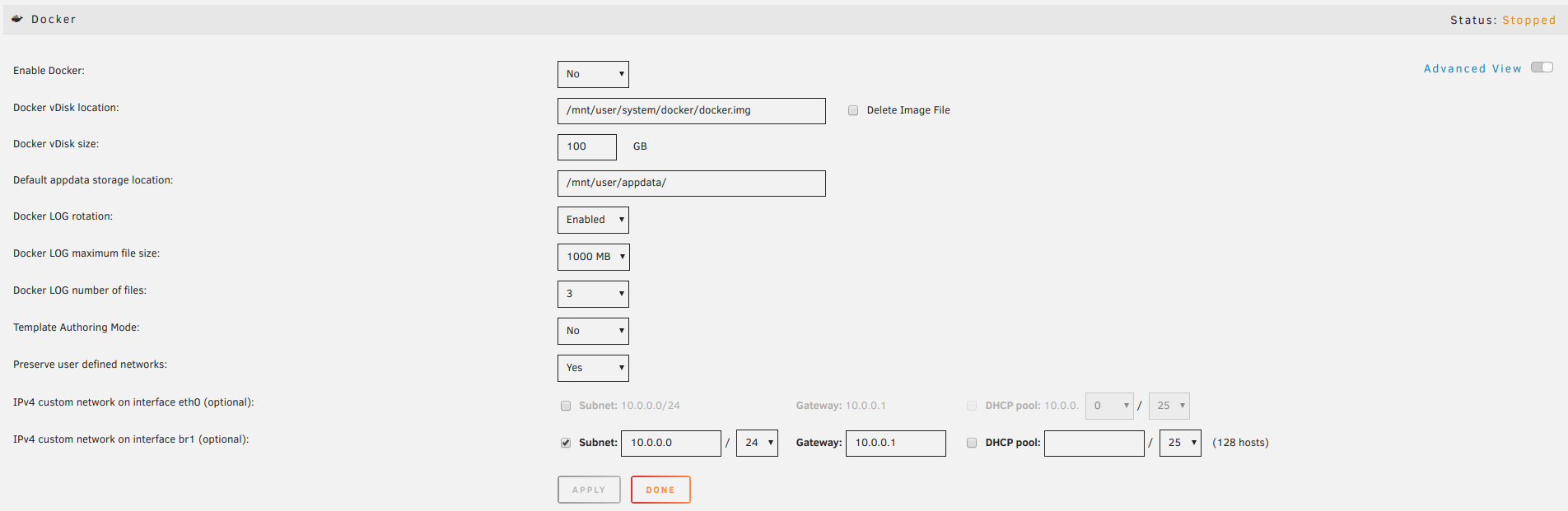

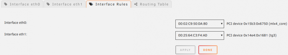

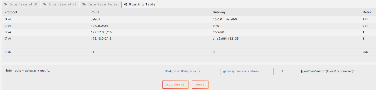

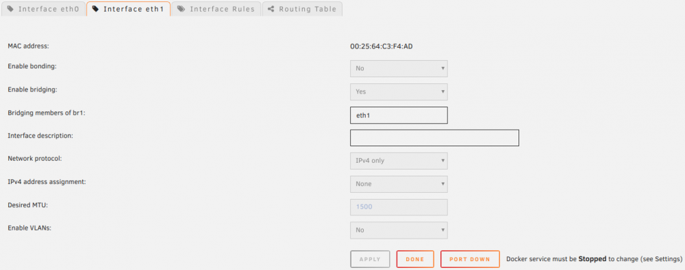

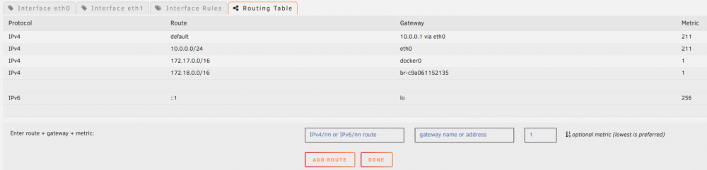

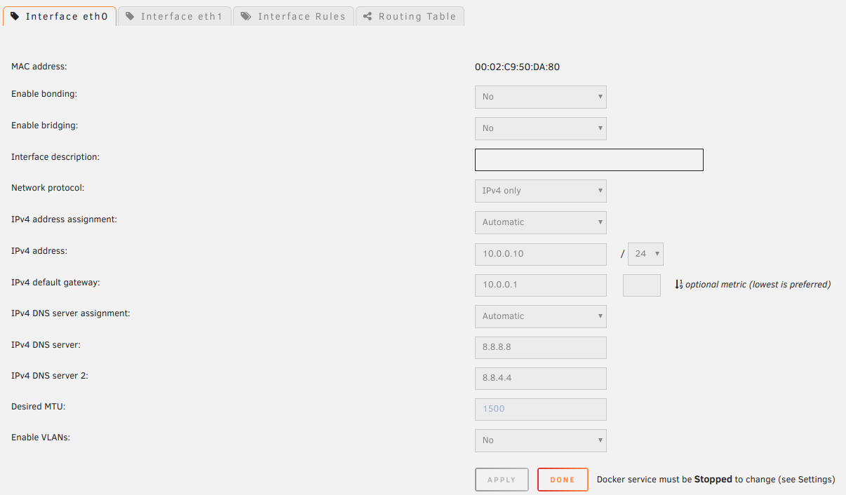

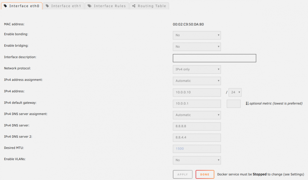

I have 2 interfaces in my unRAID box, eth0 and eth1, I have configured unRAID as follows:
  • eth0 has the ip 10.0.0.10 via DHCP (static lease), bridging is disabled
  • eth1 has no ip, bridging is enabled (br1)
  • Docker custom network on br1 is 10.0.0.0/24, default gateway 10.0.0.1, no DHCP.
  • I spin up every docker container with a specific IP on br1 (between 10.0.0.128 and 10.0.0.254) and I provide the --dns=8.8.8.8 flag.

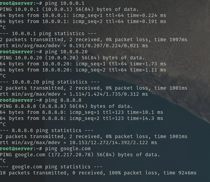

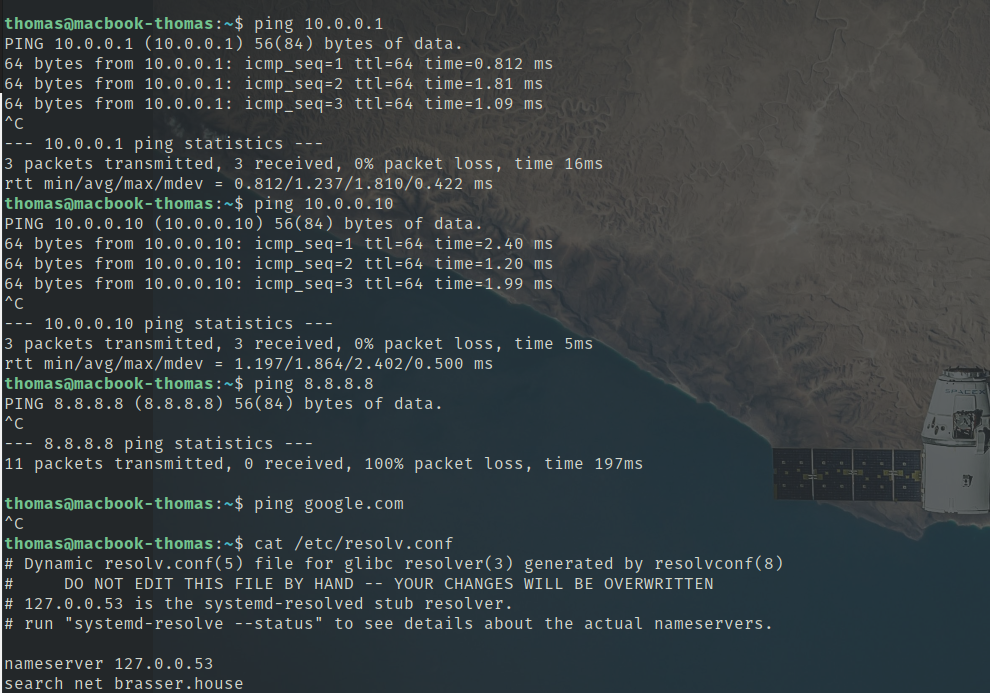

The problem I keep facing, and the reason I went and configured everything as above, is that whenever I make changes on how devices on my network access the internet (over VPN or not etc) I get weird DNS issues, either my unRAID host can't ping google.com, or my docker containers are unable to resolve domainnames.

Here are some screenshots and outputs of various commands:

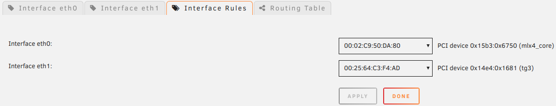

- unraid gui settings related to networking and docker

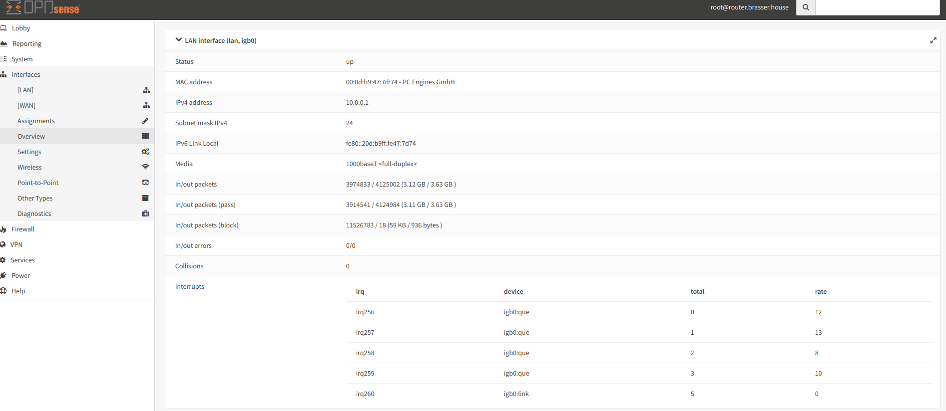

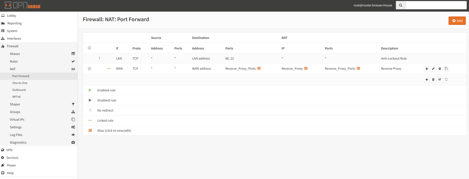

- opnsense gui settings related to dns/dhcp and overview

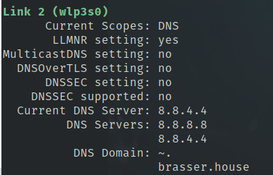

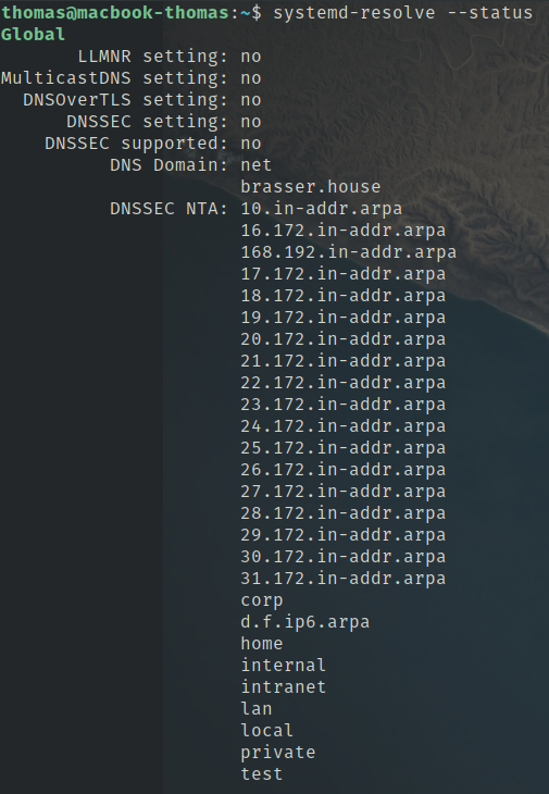

- ping and dns results from my laptop (10.0.0.20)

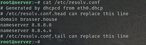

- ping and dns results from the unraid host (10.0.0.10)

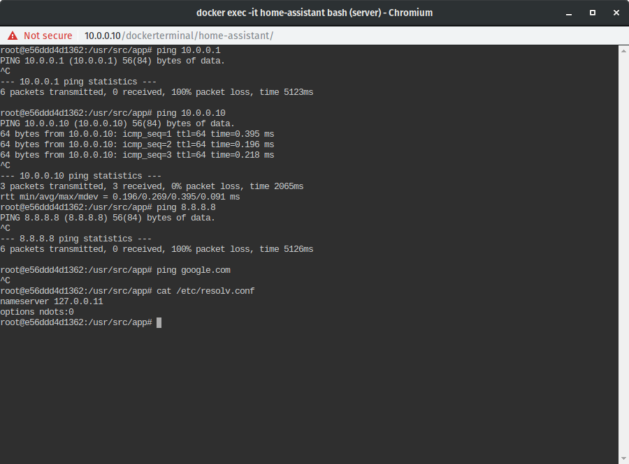

- ping and dns results from a container started with --dns=8.8.8.8 on br1 with 10.0.0.181 ip
Can someone help me debug this? I haven't been able to get a stable network for ages now, and I have no clue what I'm doing wrong.
