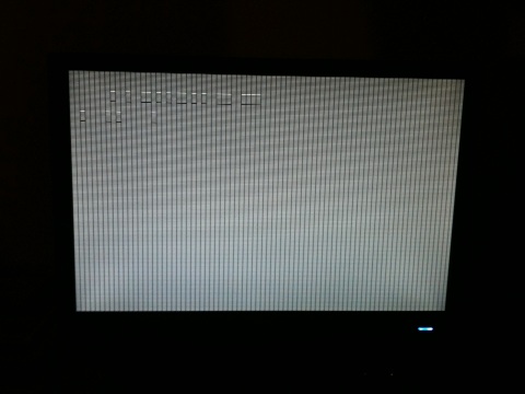

So, Alt-F2 (to F6) take me to equivalent garbage screens. I can see a cursor blinking about where I would expect the login prompt, but the screen is completely unreadable.
I've attached a picture of the screen.
