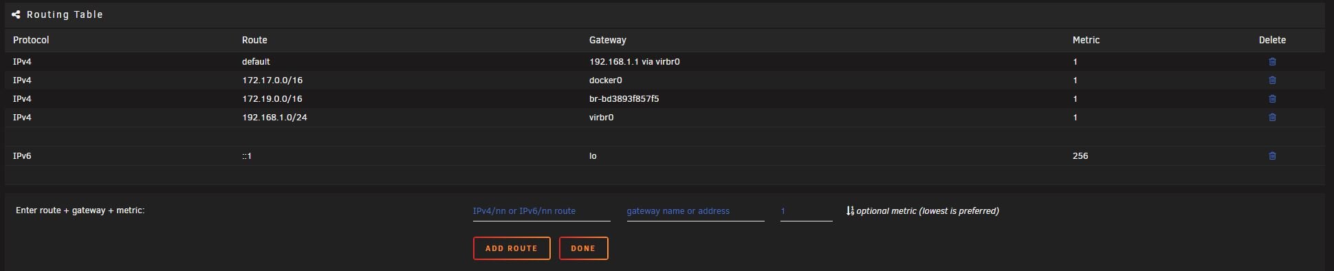

I set up a virtual bridge between my PfS vm and the host. I disconnected the ethernet cable from the server and set up a route to my PfS firewall using the virbr0 interface, so my routing table looks like this:

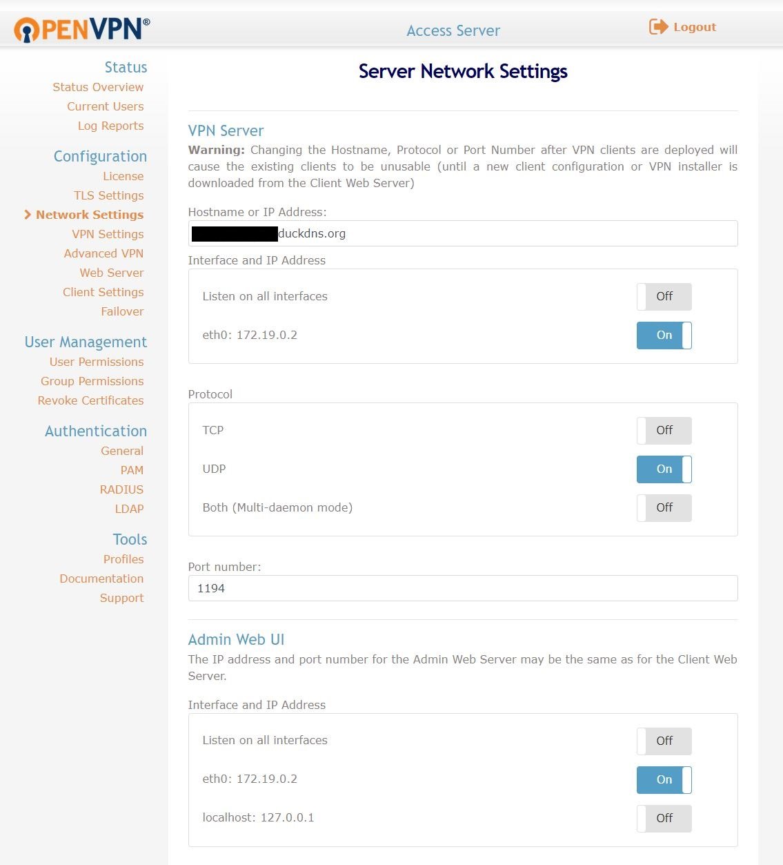

- My other problem is a bit more serious, as docker does not recognize the virtual network bridge, containers can't directly see them as well:
The pic above is my ovpn client servers network config, and it is seen that I can only select the containers own loopback interface, and the custom docker network for the server to listen on.
This issue also effects delugevpn as well (and any other container that has to know the machines ip, mostly VPNs).
