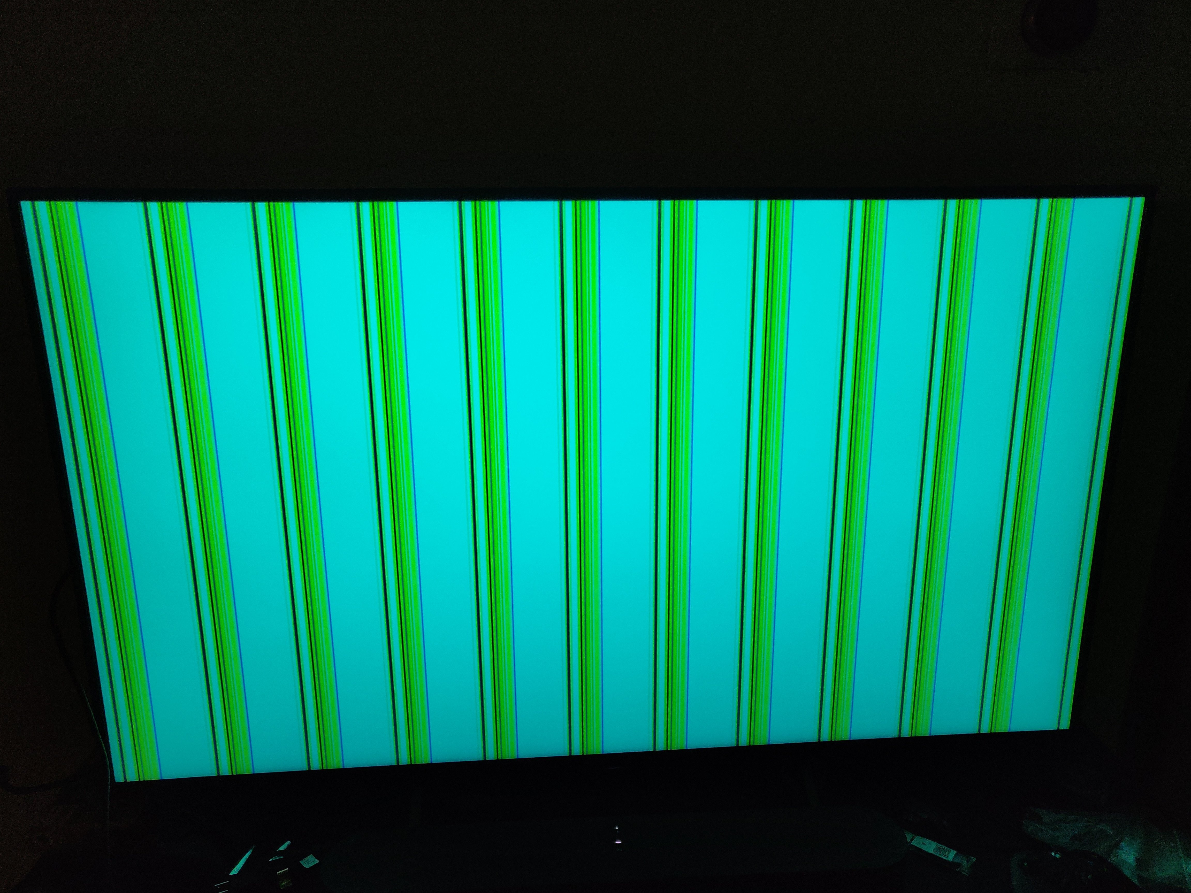

I am new to unRAID but I have gotten through setting up an array and creating a share, which I am able to access from my laptop. The case is HTPC size and fits in the entertainment center, so I am trying to set up a VM with passthrough so that I can watch movies - I've made some headway in that I've gone from complaints about IOMMU group, to the video blanking out and then the TV not detecting a signal when the VM starts, to getting a signal that indicates a problem (it is green or teal with some vertical lines). But I have not been able to get it to fully work experimenting with different BIOS options.
So far choosing the OVMF BIOS option got me no signal, and the SeaBIOS option got me these vertical bars. I have to reboot to get rid of them, the VM refuses to stop through the UI.

I've tinkered with this a bit more - I have changed the BIOS so that now unRAID is booted through UEFI. Now I do not get a solid screen, rather I get a flash of the pattern from before followed by a black screen (not no signal, the display uses blue for no signal).
