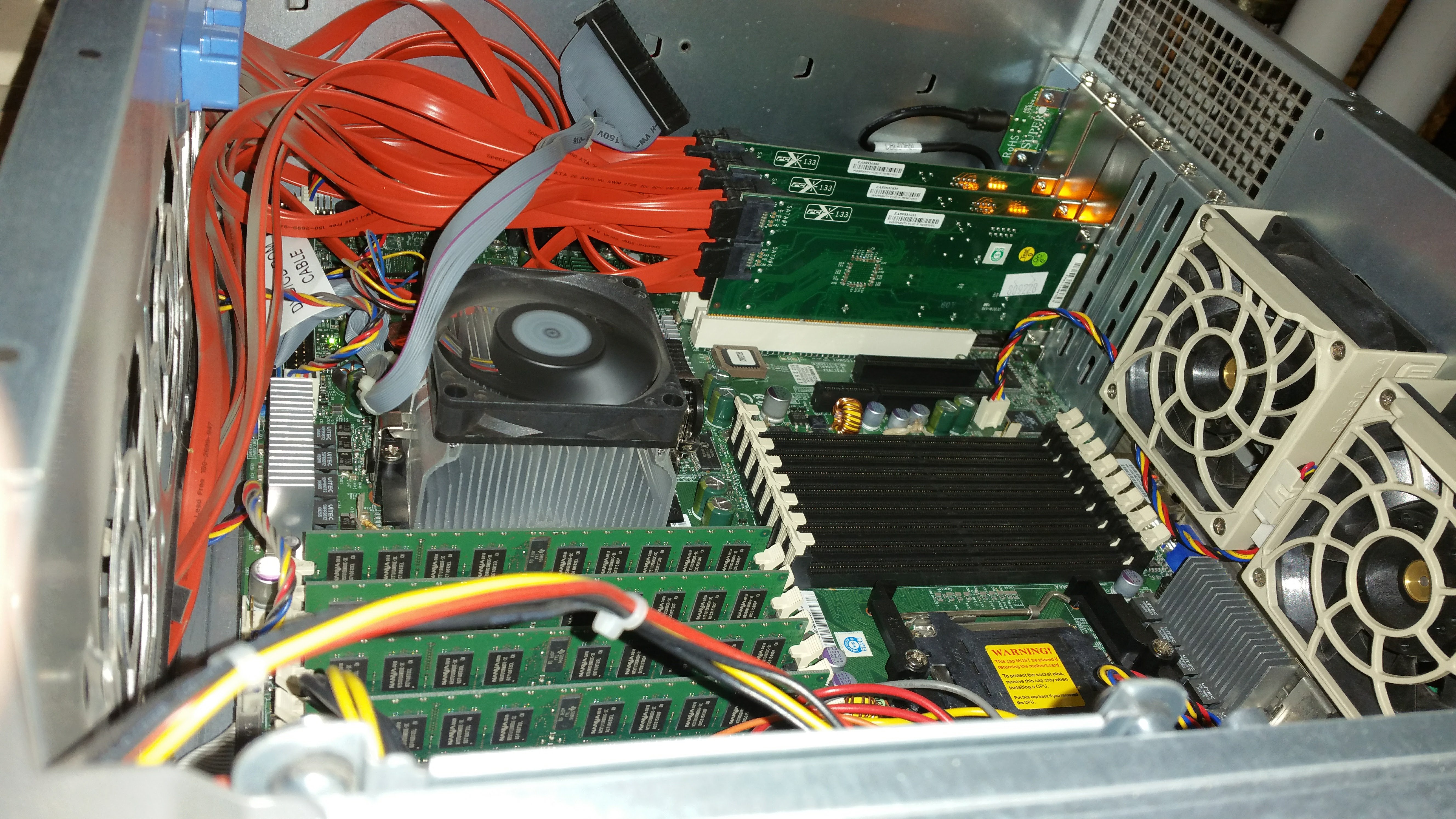

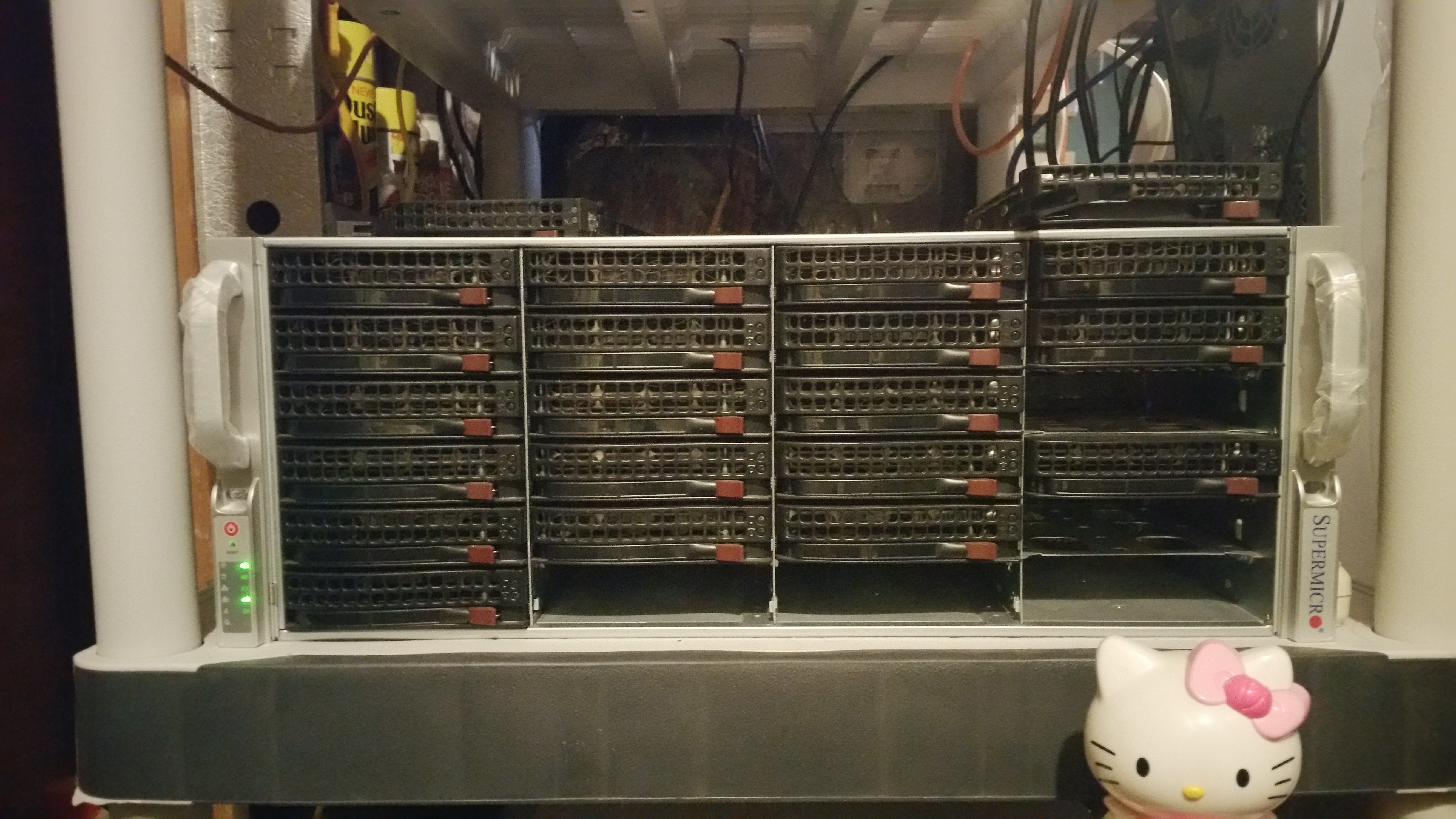

  It is an old SuperMicro server that had been retired I got for a great deal a few years back.
OS at time of building: Unraid 4.5.3
CPU: AMD Dual-Core AMD Opteron(tm) Processor 2212 HE
Motherboard: SuperMicro H8DME-2 REV 2.01
RAM: 8GB
Case: SuperMicro SC846 series
Drive Cage(s):  stock - part of case chassis
Power Supply: stock - 2 ea redundant configuration
SATA Expansion Card(s): 3 ea SuperMicro SAT2-MV8 PCI-X cards
Cables: stock
Fans: stock
