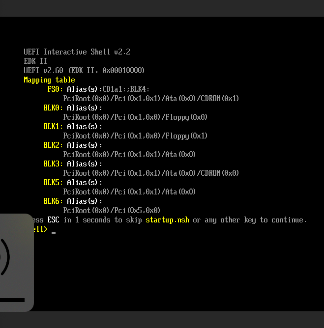

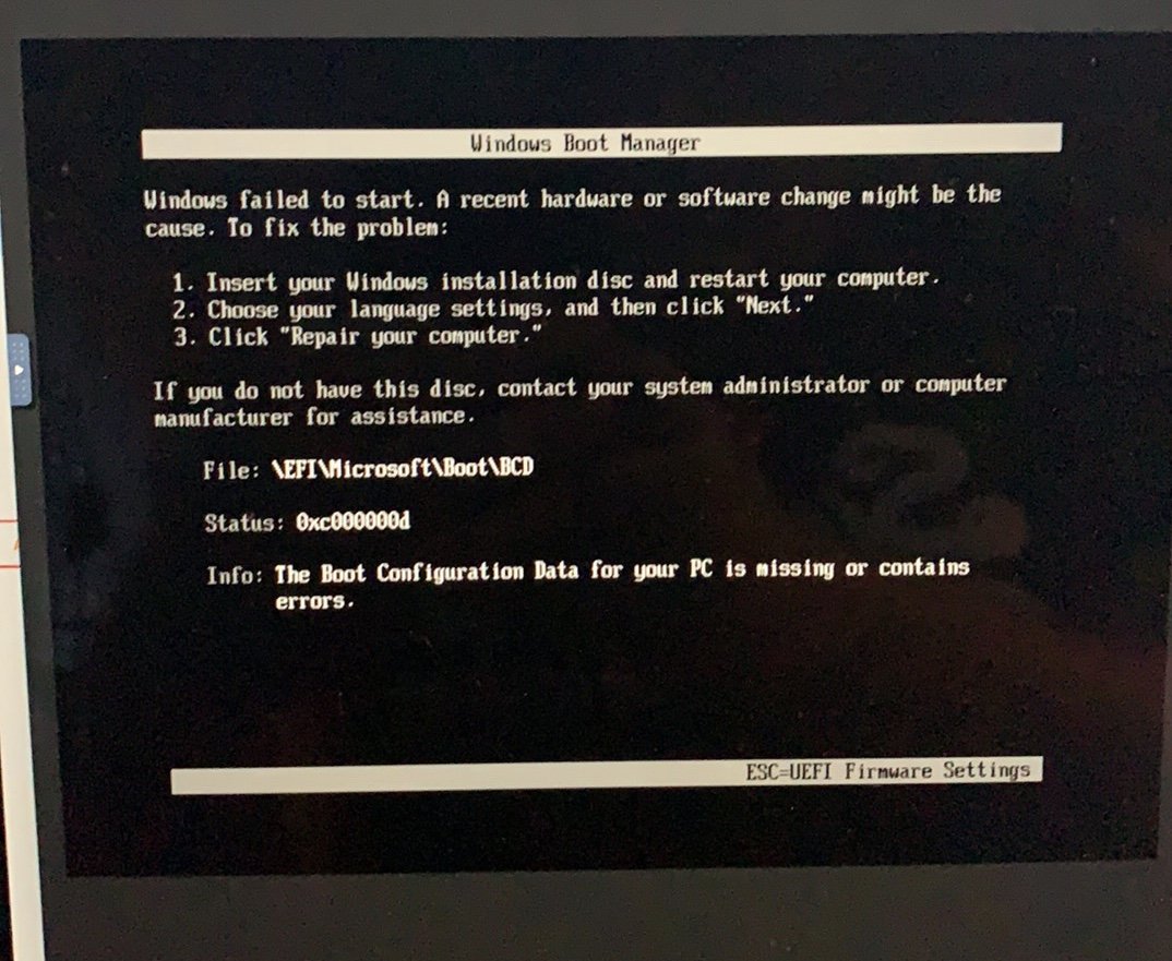

I have one situation where i Get a black Window with a _ symbol blinking followed by the windows boot logo hanging(evidenced by the vm pausing itself), and in instance two I get some kind of UEFI-related error. See attachment.
Try creating a fresh VM with nothing passed through to it. Install Windows then go back and pass through your devices. Make sure your install ISO is up-to-date.

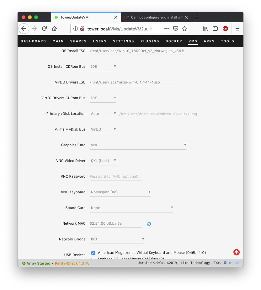

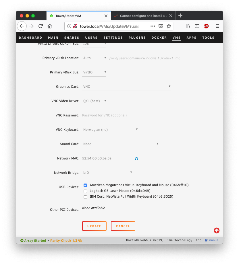

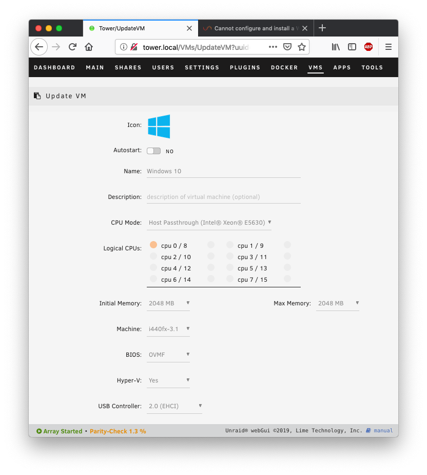

First attempt:
Edited by SpecFroce
At the UEFI Interactive Shell prompt, type
exit
and press enter.
exit
and press enter.

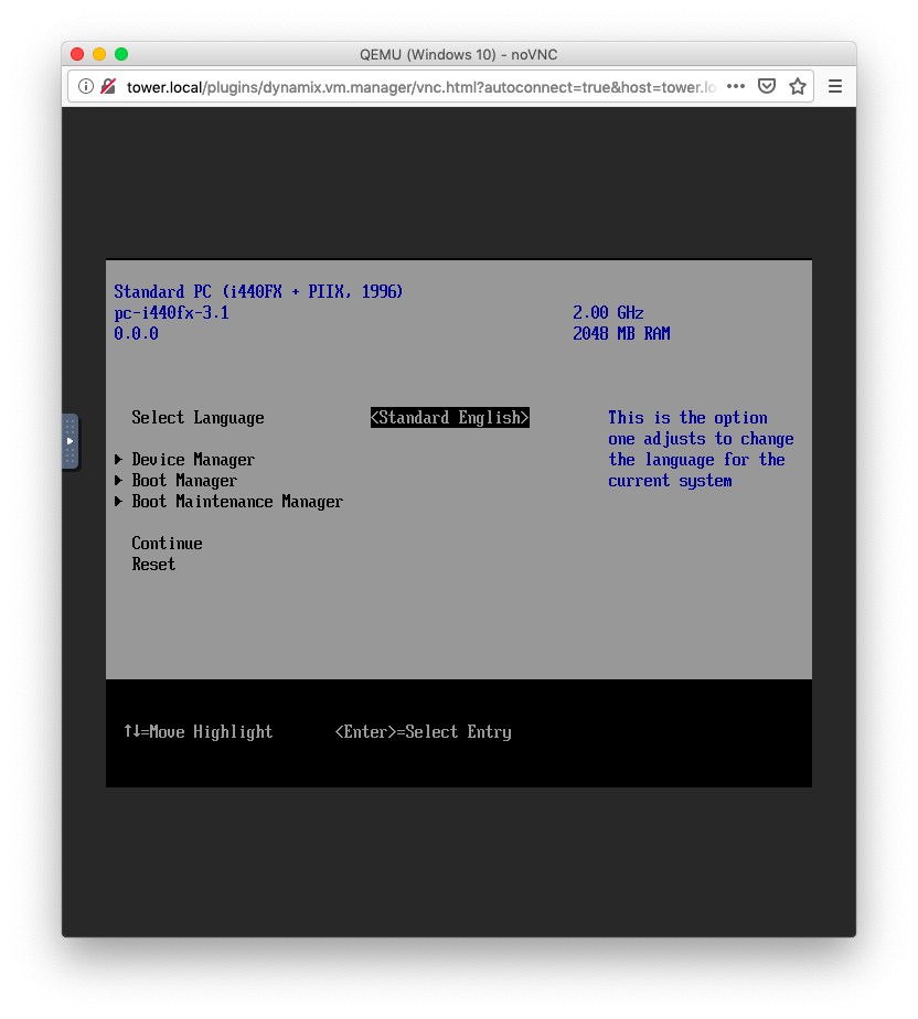

It just throws me into the virtual bios after writing exit and gives the initial windows boot error i posted when i press continue in the bios window.
In that case, your ISO is probably corrupted. Try downloading a new one from Microsoft and try again.
