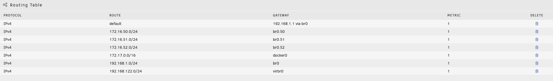

Capture_1 = after reboot

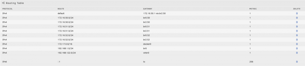

Capture_2 = remove br2

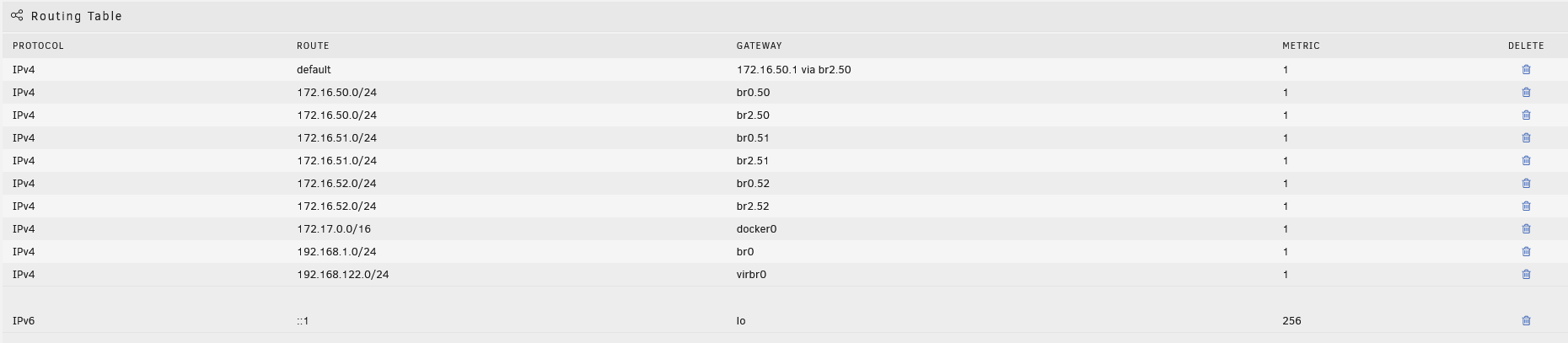

Capture_3 = after the old br is removed, and new correct null route is created
But if i reboot the machine, I will be back at "capture_1" -please help!
