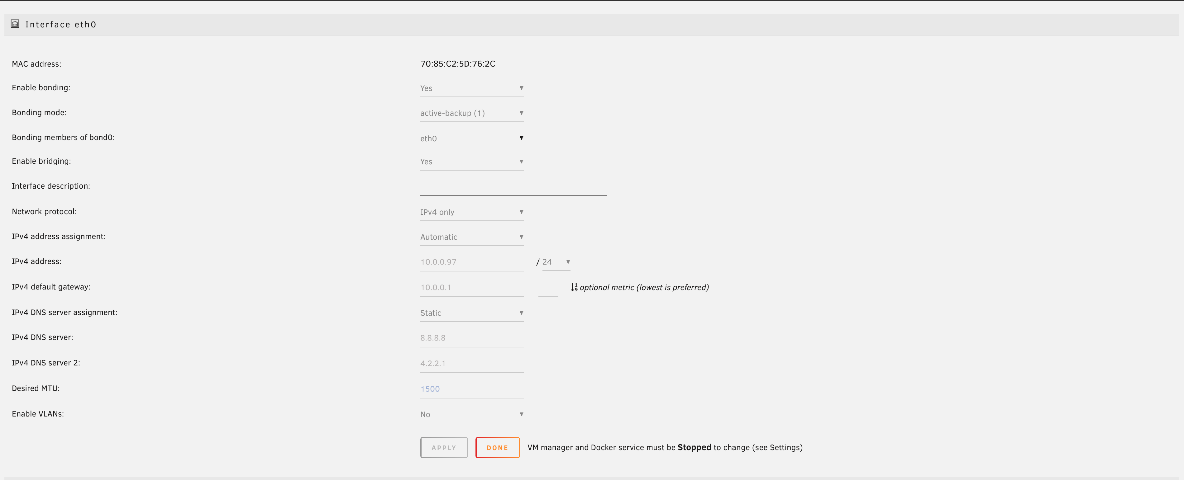

So I was able to change my settings from "Enable bonding" to "Bridging". But I only see eth0 to pick. Also I still don't get to specify an IP when I pick Bridge mode in docker.
Screenshot attached.

Actually read the text on the screen.
Enable bonding: No
Enable bridging: Yes
Bridging members of br0: eth0
pihole docker>edit Network Type: Custom : br0
