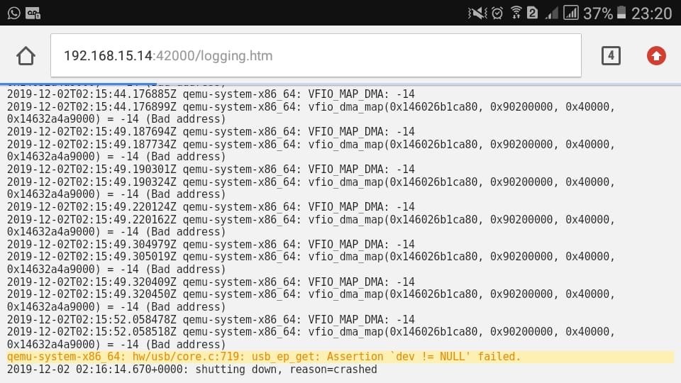

The problem is, when I turn on the virtual machine with the interface USB plugged in without the drive, the audio gets choppy and sizzling.
When I connect with the USB plugged in and the drive installed, the moment my win10 plays some sound, it crashes and that message pops up.
672968426_WhatsAppImage2019-12-02at00_51_48.jpeg.5fca4c421a40f8fc8fa27c6d78615db3.jpeg
Right after the crash VM crash.

I found a person who had a similar problem, not exactly the same.
But there is the same mistake, there was an answer regarding qemu.
(link: https://bugs.launchpad.net/qemu/+bug/1833053 )
I don't understand much about this qemu, how do I change it exactly? can this really have a problem?
Tools -> Diagnostics -> attach zip file.
Also what Unraid version are you running? I suspect 6.8.0 rc?
In your xml, there's this line.
<type arch='x86_64' machine='pc-q35-4.1'>hvm</type>
Change it to:
<type arch='x86_64' machine='pc-q35-3.1'>hvm</type>
That should change your Q35 machine back to v3.1
But, (and it's a big but), Q35 below 4.0 makes your PCIe runs at x1 so you need to add these codes to the end of your xml (manually) before </domain> so that it can run at full speed.
  <qemu:commandline>
    <qemu:arg value='-global'/>
    <qemu:arg value='pcie-root-port.speed=8'/>
    <qemu:arg value='pcie-root-port.width=16'/>
  </qemu:commandline>
This is assuming the root port patch hasn't been removed.
If it were removed then you would also need to downgrade to Unraid v6.7.2 (or create a new template and use i440fx machine type, again v3.1).
The best fix though is to pass through a USB PCIe device to the VM and use your Yamaha plugged into that. Hence I asked for Diagnostics to check your IOMMU group + available devices.

Hi Alright, thanks so much for the reply and sorry for my delay.
I made the changes to the XML you spoke, but when I turned on the screen only goes black.
I'll be sending the diagnostic you asked me.
fdge-diagnostics-20191203-1156.zip
And yes, i'am using the lastest version.
note: i generet the diagnostic before your changes.

The problem of using i440fx, and i'm using an AMD video card (rx 580) and for some reason when i update her drivers on i440fx goes black, it just worked on the Q35.
I'm having trouble.
I messing here just now gave another error when starting the VM:
"internal error: Unknown PCI header type '127' for device '0000: 01: 00.0'"
I hope this is not a reason to delete the VM, because there are important files inside, any problem has how to recover right?
I'll be sending the diagnosis again please help me kk
fdge-diagnostics-20191203-1326.zip
"Device attached successfully error: Failed to attach device from /tmp/hotattach.tmp error: internal error: cannot parse product 0x0289#remove"
whats mean?
I hope when you picked i440fx, you followed my advice to create a new template and not tried to edit the current template.
Editing the xml template does not have any impact on your actual VM. All you need to do is to edit your not-working template in xml mode and then copy-paste your old code (presumably that's the xml you attached in the first post), save and then everything should be back to what it was.
