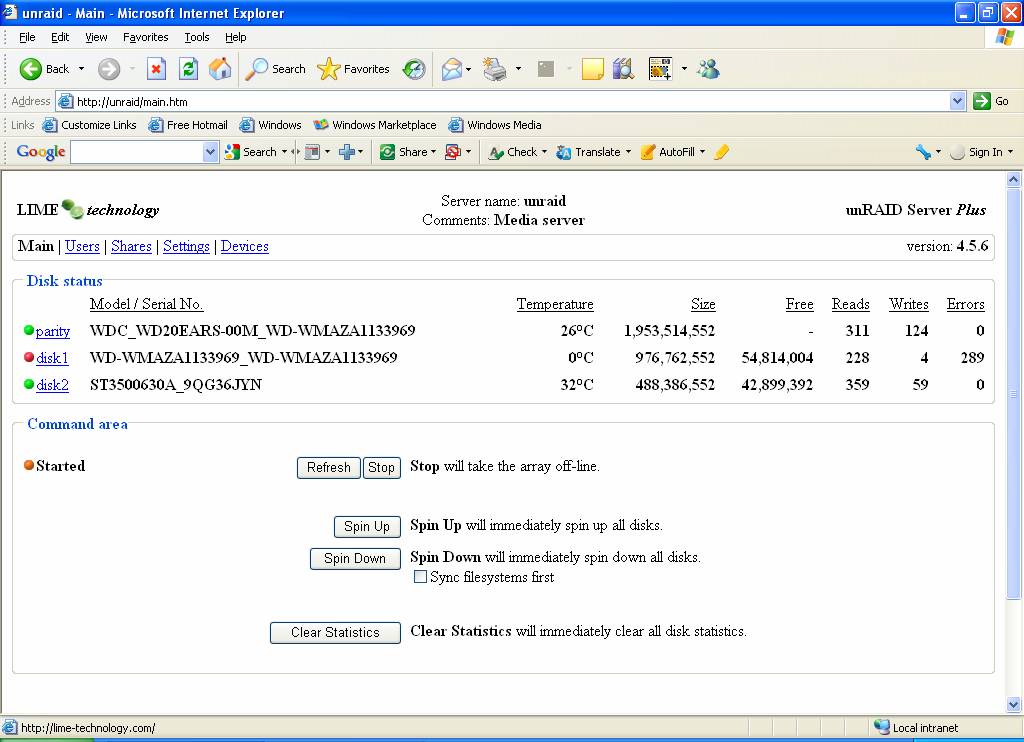

My BIL added a new SATA card and it wasn't showing up in unRaid.  We updated the BIOS on the SATA card and rebooted.  When unRaid finished booting, we saw the red ball for disk1 with 2 errors.  I thought my BIL might have jostled the SATA cable to disk1.  We powered down unRaid and re-attached the SATA cable to disk1.  We powered up the unRaid server.  We stopped the array, un-assigned disk1, started the array, stopped the array, assigned disk1, and started the arrary.  The redball came back for disk1.  This is way out of my league.  :-[
I need some expert help.  I have attached a screen capture of the red ball.  Here is the syslog:

You've basically done everything right so far.   You've atttempted to re-seat the connectors on the SATA cable to disk1.
When you un-assigned, started array, stopped array, re-assigned disk1 the unRAID server attemppted to write to the drive to re-construct it:

It was unable to write to the drive, therefore it is still marked as "red"
