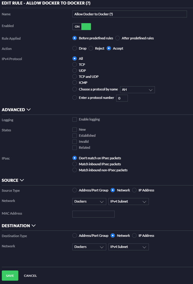

I know it's a long shot but have you found the fix for this? I have the suite of "arr" apps trying to set it up on a custom macvlan network and the traffic is being blocked by my firewall. Why is the traffic going through my firewall if they're all on the same macvlan???
TBH, I can't remember the complete context of this. What I do know:
1. My -arrs are now using the network of my VPN container so their traffic is routed through the same VPN tunnel.
2. I added this really odd feeling firewall rule and disabled "Drop Invalid":
Preface: I'm far from a network guru, hobbyist at best.
Looking back on it... The VPN containers probably use a internal private network. Whenever the application inside the docker container communicates to your LAN it's technically communicating from the network inside of the container and needs to be routed, thus hitting the firewall. The router has no idea about that network inside the container so it gets marked as invalid?
I'd still love to know the definitive answer if anyone has one.
