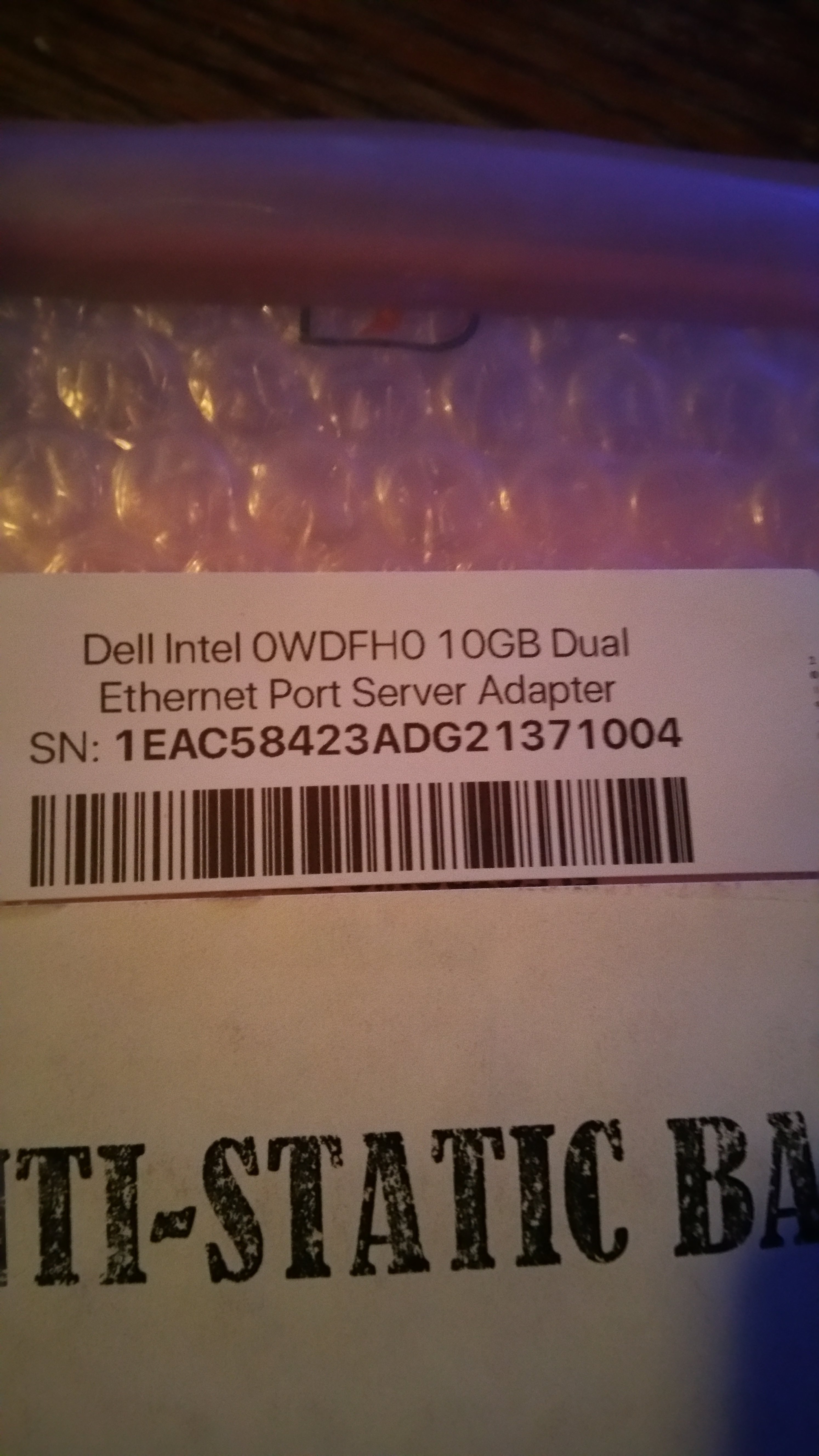

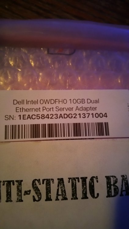

Hello, 3 months into my plex unraid server and loving it. Today at work I received a text from an upset family member that plex wasn't working, so check and confirm that it wasn't working. So I couldn't wait to get home to see what was going on and no internet connection. Started troubleshooting my Asus Rt-AC56r router tried everything install firmware, reboot and, reconfiguring the parameters long story short, when I plug in my server with Asus Maximus hero 7 motherboard it knocks out the router. So, I'm assuming my onboard ethernet is hosed. I have an ethernet card that I purchased a month ago, but never installed was unsure of compatibility with unraid its a dell intel 10GB card. Look for the best course of action to solve my problem.
Attached is a picture with the serial number of the card.
Thanks Dave

Maybe try passing the card through to a vm to verify it works correctly? You can isolate it to it’s own vlan with a switch as not to disrupt traffic for everyone else?
