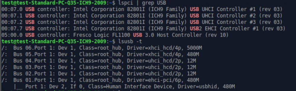

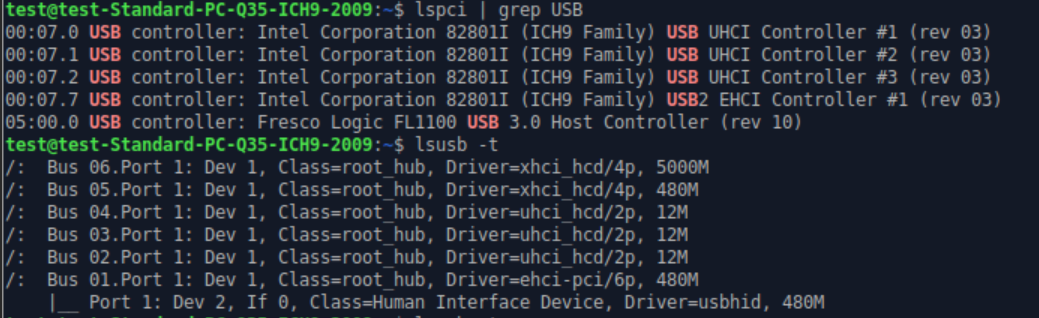

I just tried to use the USB-Controller in a freshly installed Xubuntu-VM. Using lspci and lsusb resulted in the following results.
So the controller seems to be listed, anything i plug into the usb slot are is not working.  I retried it using different pcie slots on the mainboard.
Could it be broken?
Okay the first usb-controller was broken. I got a new one and now everything is fine.
