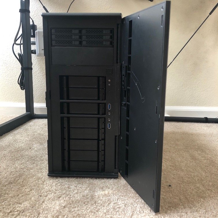

SilverStone CS380 w/ 6xHDD + 6xSSD
I had a bunch of HDD's, SSD'ss and RAM sitting around from server project I never built. My immediate use case is a higher end Plex server as my Synology is close to capacity.

Total cost for new parts was ~$650. Equivalent Synology to support drives/ssd + ram upgrade would have been $2k+ and would still have less cores and memory.
Overall I'm pleased with build. Plex streams 4k w/ no issue and only slightly louder than my Synology. I’m also starting to use Unraid as spill over for larger dev VM’s that don’t fit on my laptop.

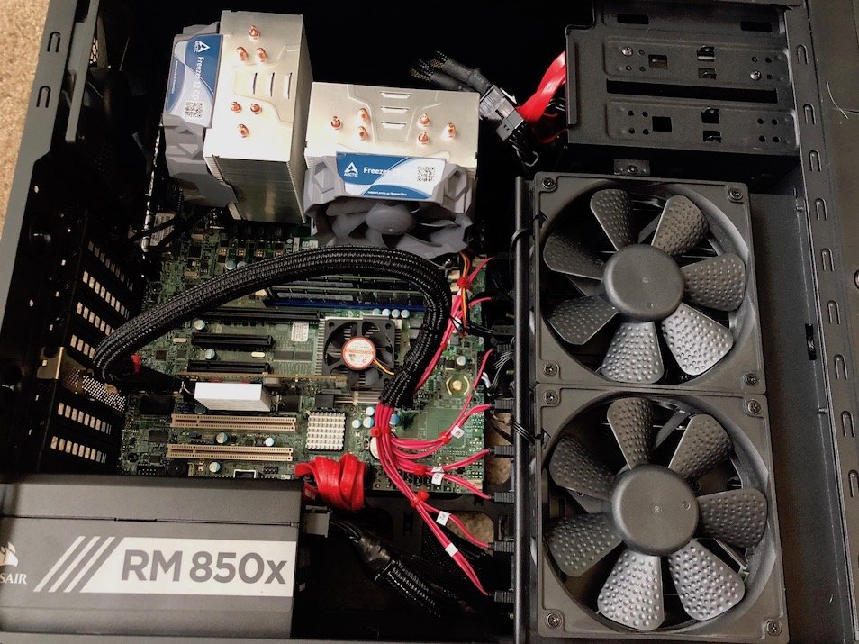

  • Many posts state the Arctic Freezer 12's work on X8DTL boards with supplied adapters which was untrue in my case. The screws are about 1/8" too long so I used a few washers as spacers. Worth noting, I tried four different coolers and theses were by far the best.
  • Originally I had both cpu cooler/fans facing toward rear but the front CPU ran a few degrees hotter as the fan blew directly into back of rear cpu cooler/fan. I rotated 90 degrees and they now run at same temp.
  • I originally purchased the Mediasonic 6 x 2.5 but it had intermittent issues with ssd's so swapped it for the Icy Dock.
  • I glued the StarTech fan directly to the chipset heatsink with thermal glue. It's more permanent than I'd like but cleanest solution I could find.
