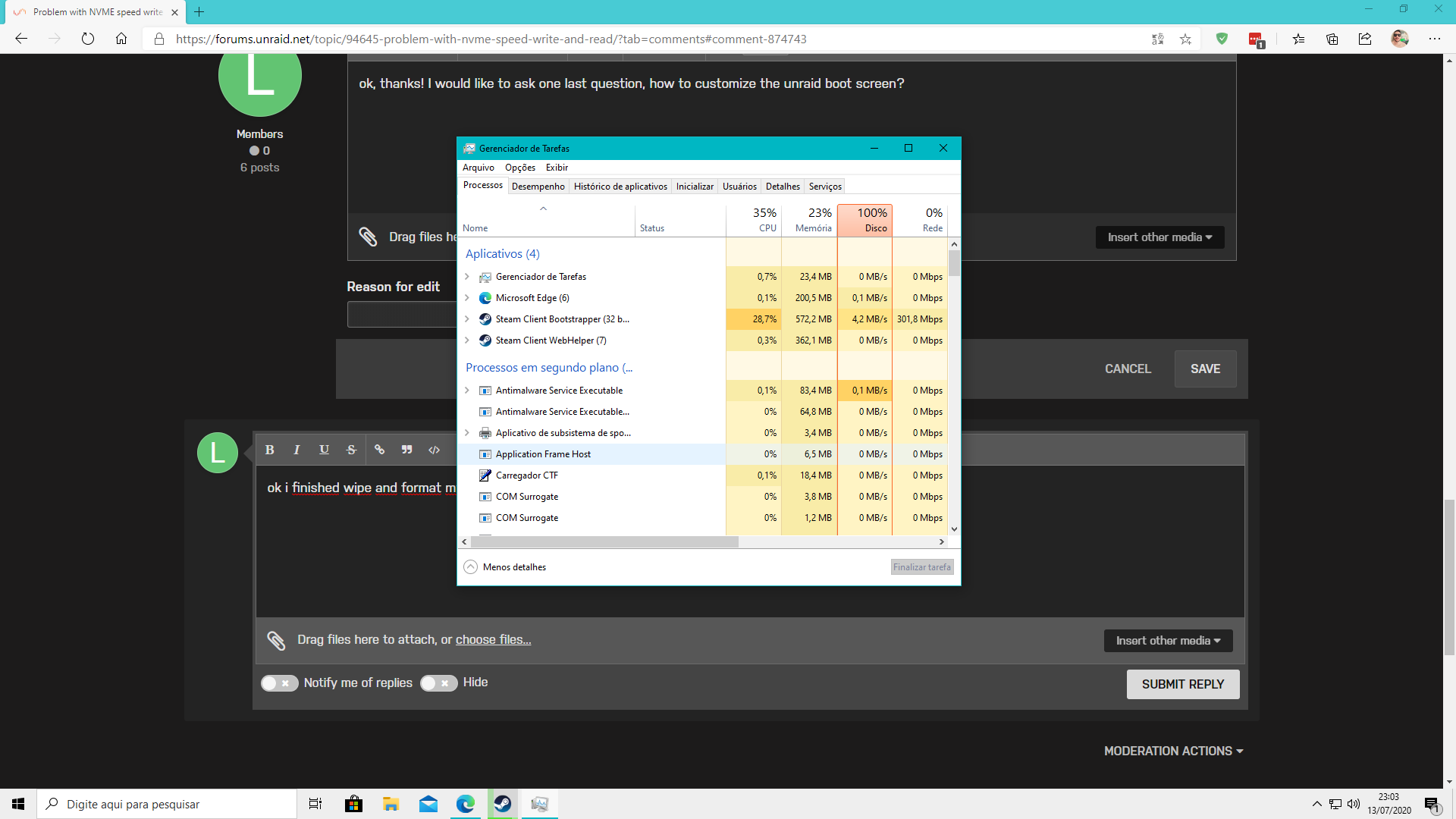

July 15, 20206 yr Hi guys, i have this problem with my unraid, and i cant fix this, any way to solve this problem?

July 15, 20206 yr Author Thanks for help, it happen all time when a downloading a file, i attached diagnostics file! lkzserver-diagnostics-20200715-0737.zip Edited July 15, 20206 yr by lokize

July 15, 20206 yr Author downloading in internet, dont matter software i use, in only windows system this nvme is very fast, no problem with 100% of usage when downloading a file, before creating this topic I did all the wiki procedures and tried several settings on the VM, none of them were successful!
