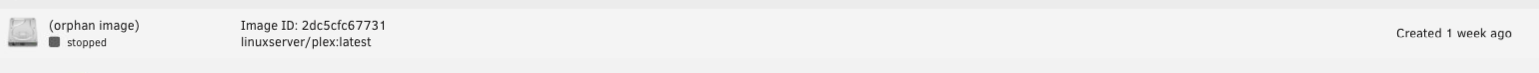

Hello there,
i messed up my Plex container.
I read in a thread how to give a docker a MAC address (i'm new to unraid and try a lot of things)
there was something written which i copy&paste to extra parameters.
the docker try to restart with the new parameters but there was an error message.
i could only click "done"
and now it is an orphan image
is it possible to clear my mess out of the extra parameter.....with the terminal or somehow?

Go to Docker -> Add Container -> pick the template from the drop-down list. It will have your last parameters

I‘m trying to get a static global ipv6 to my Plex Server so I can reach it from external.
So I reinstall the Plex Docker?
Yes, revert the problematic parameters and reinstall Plex docker and it will come back.

Thanks, Plex container is back again.
External access is the next thing to solve but this thread is solved.
