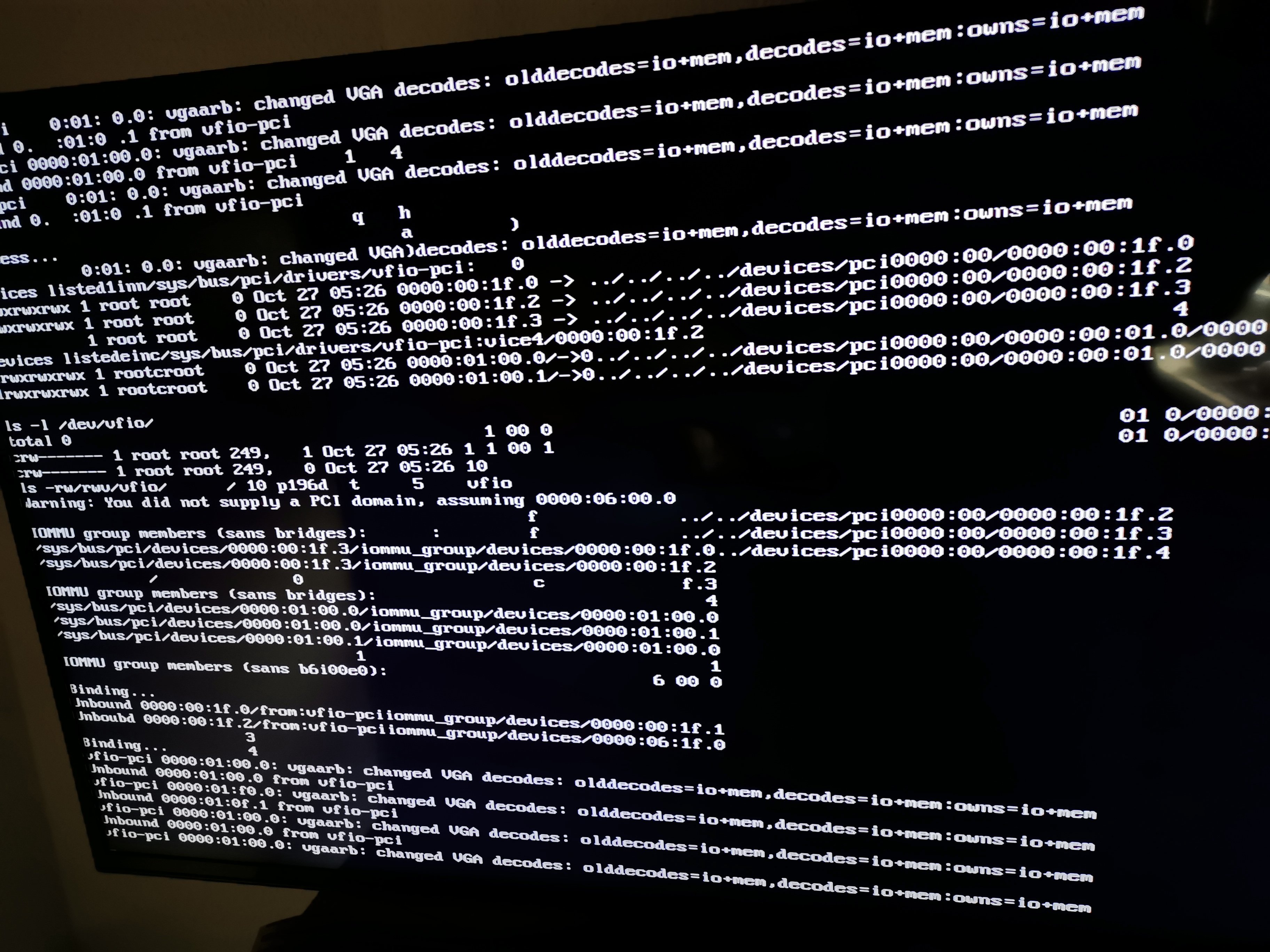

I´m new to Unraid and have installed the server (bought a key) with the help from tutorials (spaceinvader, among others). I had some problems with setting up a Windows 10 VM for gaming, with the famous Nvidia error 43 coming up. But after some research on the unraid forums and the internet i got it working after many trys using a command script at the startup of the array.
As in the tutorial from Spaceinvader i used the VFIO-PCI Config (community application) to bind my Geforce 1070 graphics card and my nvme drive. That worked (till now) great and i could use the Win10 VM without problems. But after some shutdowns of the server the Unraid OS does not boot and hangs on the following screen (see picture)
So i tryed to boot in safe mode but had the same result (hangs). This problem happned after i used the Win10 VM for some time and shutdown the server.  I think it has to do with VFIO binding but dont know how to fix this, maybe the Unraid Pros have more knowledge then i !? Any help would be great thanks.
Update: Fixed the problem by myself deleting the vfio binding in the Vfio CFG and Syslinux.cfg, if someone runs into the problem.

Was in the exact situation with the VFIO-PCI Config Plugin to passthrough my PCIE USB card. Your fix got me up and running again. Appreciate the edit 👍
My OS got stuck after a reboot to bind a GPU related IOMMU group (RTX 2060) and that was one way to fix it and boot again, thanks!
For anyone looking for these files > Plug the USB Unraid into another computer > Delete or edit out the new changes on vfio.CFG > ... > Profit!
