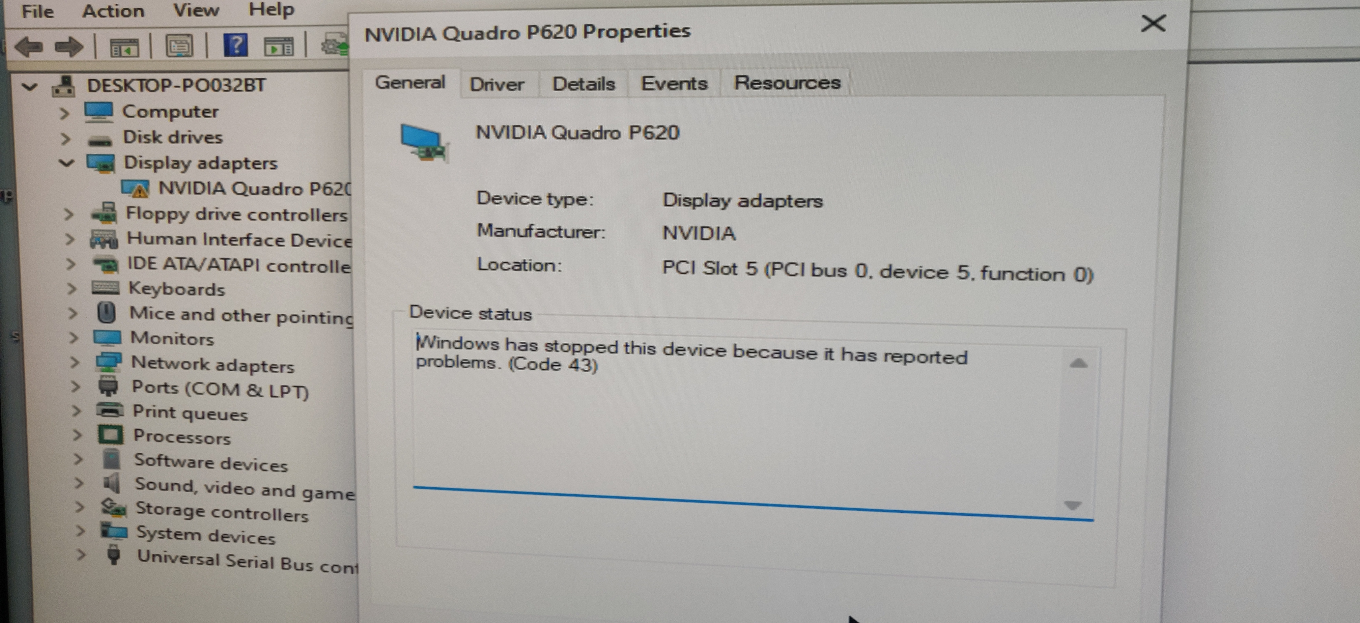

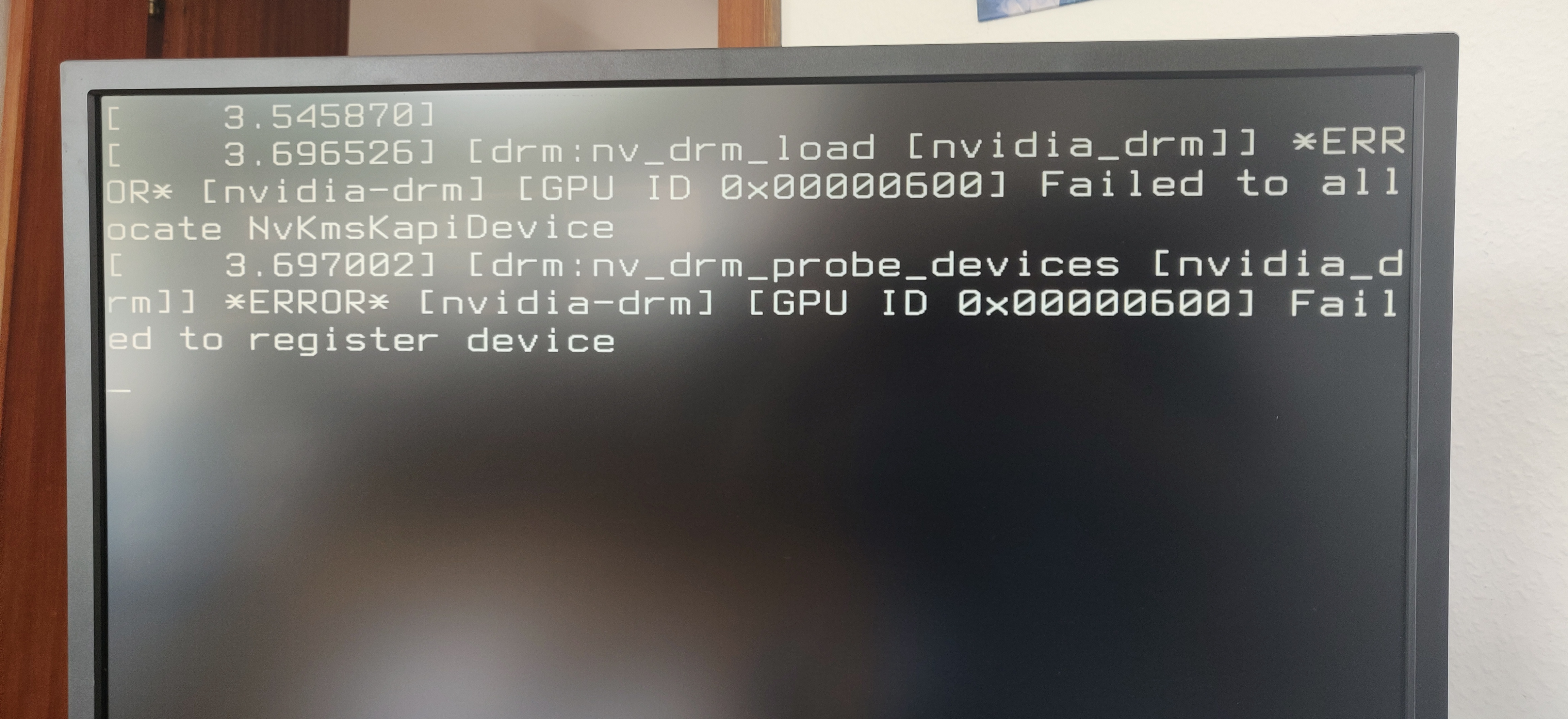

the Quadro P620 works if i use it for plex Docker (with the Nvidia Driver) but in VM's it shows me code 43 in windows and in Pop os vm it cant Initilaze the gpu correctly either

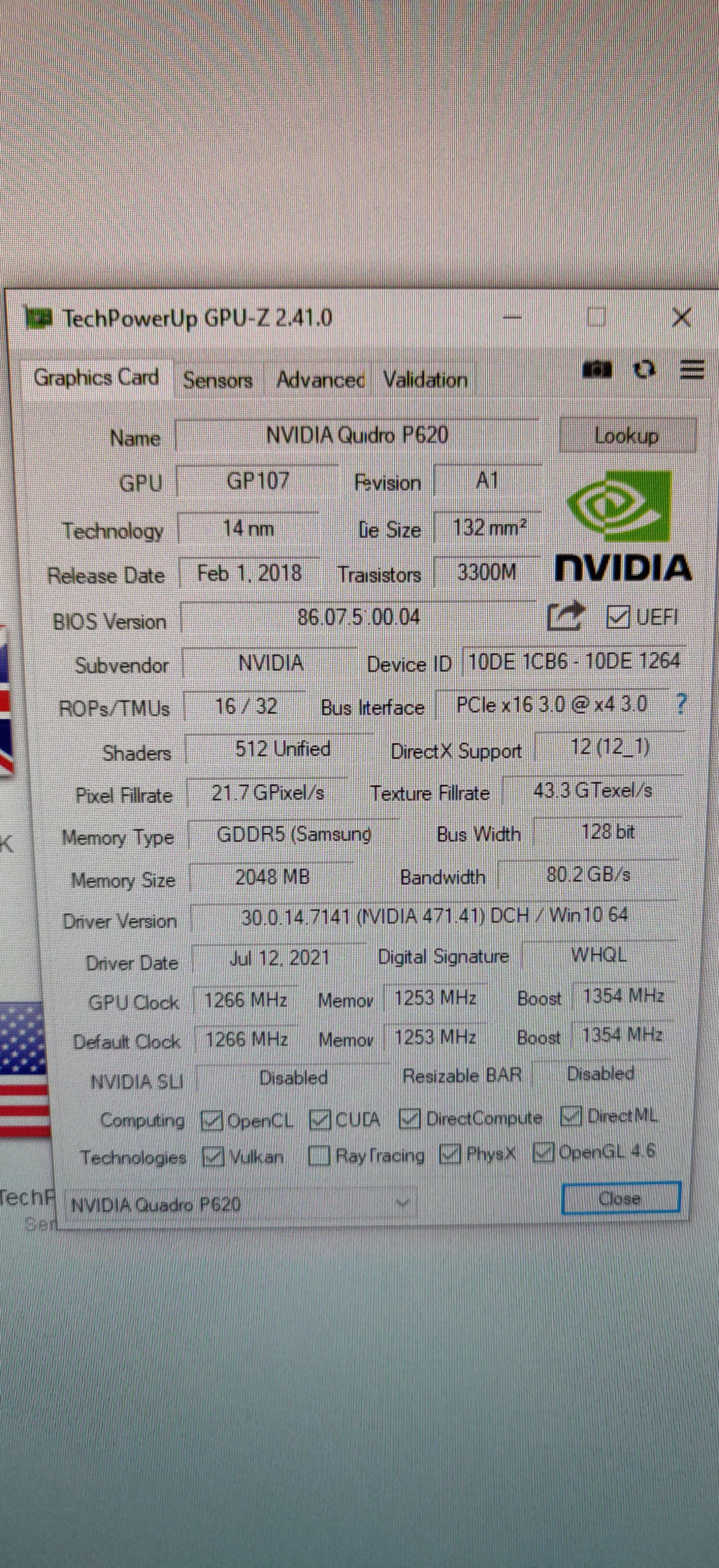

Tested the P620 in a different system and verified that the gpu itself is working correctly
