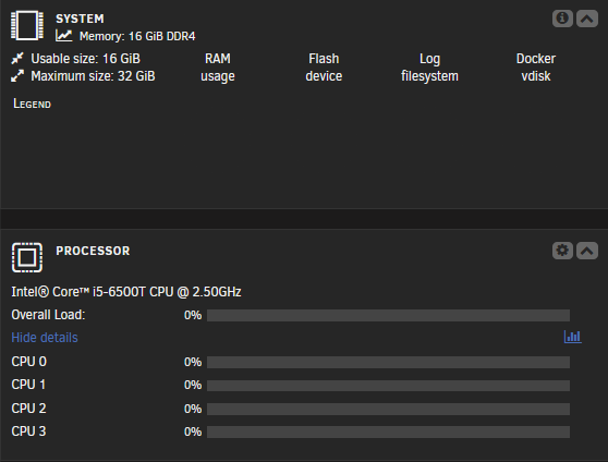

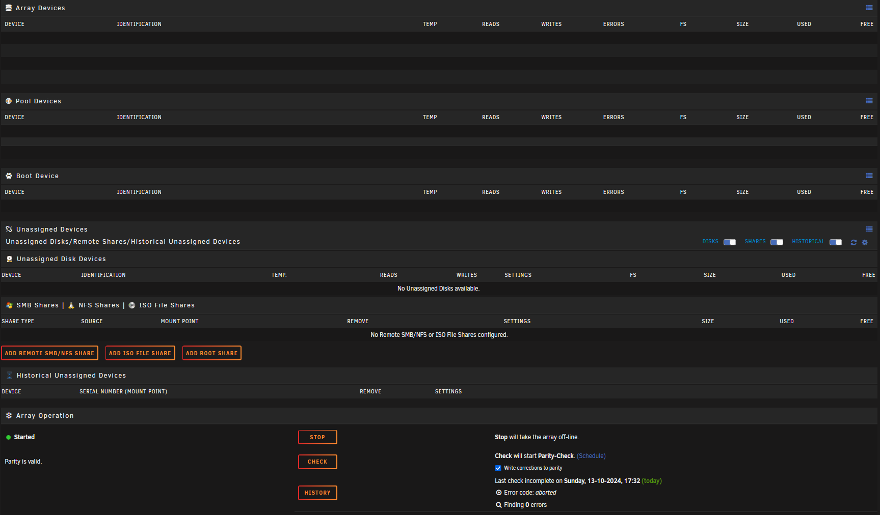

if i wanna delete some file in unraid (pictures, etc.) the deleting process is going to stuck and nothing happend. if i cancel the process after waiting some time, the file is deleted, but unraid doenst work anymore correctly. the main tab does not show any drives or pooles (sceenshot) and also on the dashboard no information is shown (sceenshot)
i also cannot stop the array nor change any other settings or see the log / console. but all docker containers are still working.
i can solve the issues by deleting the browsers cookies. than everything is shown in a normal way in unraid, i see all my drives again and the dashboard works fine. tried to delete other files and also used an other computer, which causes the same issues.
this problem existed since beta 3, in beta2 everythings works fine.
