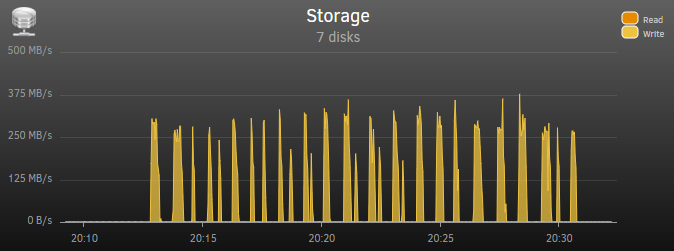

I'm seeing a write speed issue on a ZFS array disk (no parity) when the source disk is able to provide data faster than the destination disk can write it.  In a controlled test, write speed was about 80 MB/s, whereas by limiting the source speed, write speed was over 170 MB/s.
I would expect this to be reproducible on at least some systems.  My system has dual Xeon E5-2450s (not V2).  Their age and fairly weak single-core performance may have something to do with the issue, but given how drastic the difference is, I don't think that CPU limitations fully explains it.

At the command line, I navigated to the Download test folder and ran the following:
rsync -h --progress --stats -r -tgo -p -l * /mnt/user/Test/
This took 17m57s, for speed of 79 MB/s (calculated, not just taking rsync's word for it).  As you can see from the first image, write activity was very sporadic.  During the dips, one or two CPU threads were pegged at 100% (usually two).

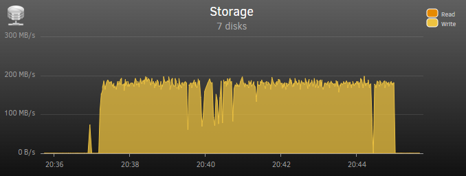

Next, I removed the files from the Test share and reran the command, this time adding the --bwlimit option:
rsync -h --progress --stats -r -tgo -p -l --bwlimit=180000 * /mnt/user/Test/
I may have been able to go higher, but I wanted to make sure to use a speed under the max capabilities of the destination disk.  It completed in just 8m12s, for a speed of 173 MB/s.  The second image shows a drastically different profile for the write activity.
Finally, just in case the order of operations had an impact, I removed the files again and reran the original command without the limit.  The speed & activity profile was the same as before.
