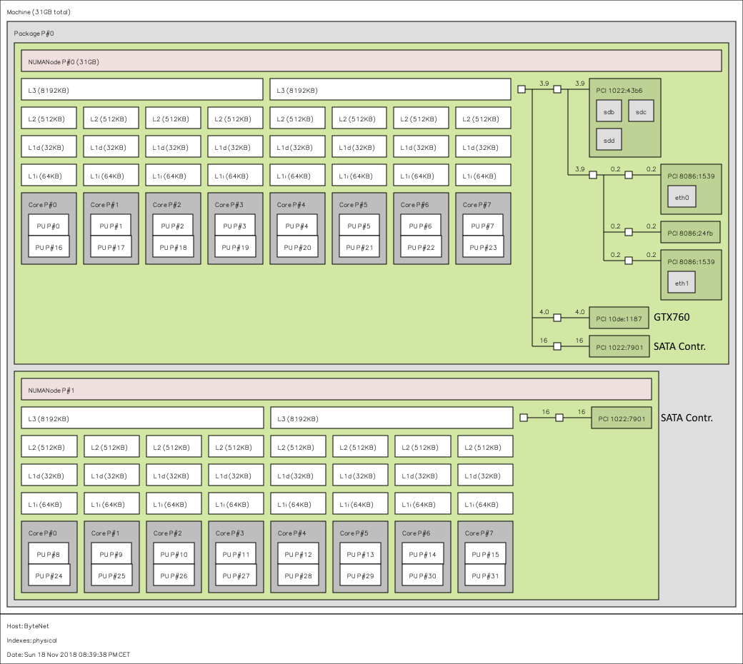

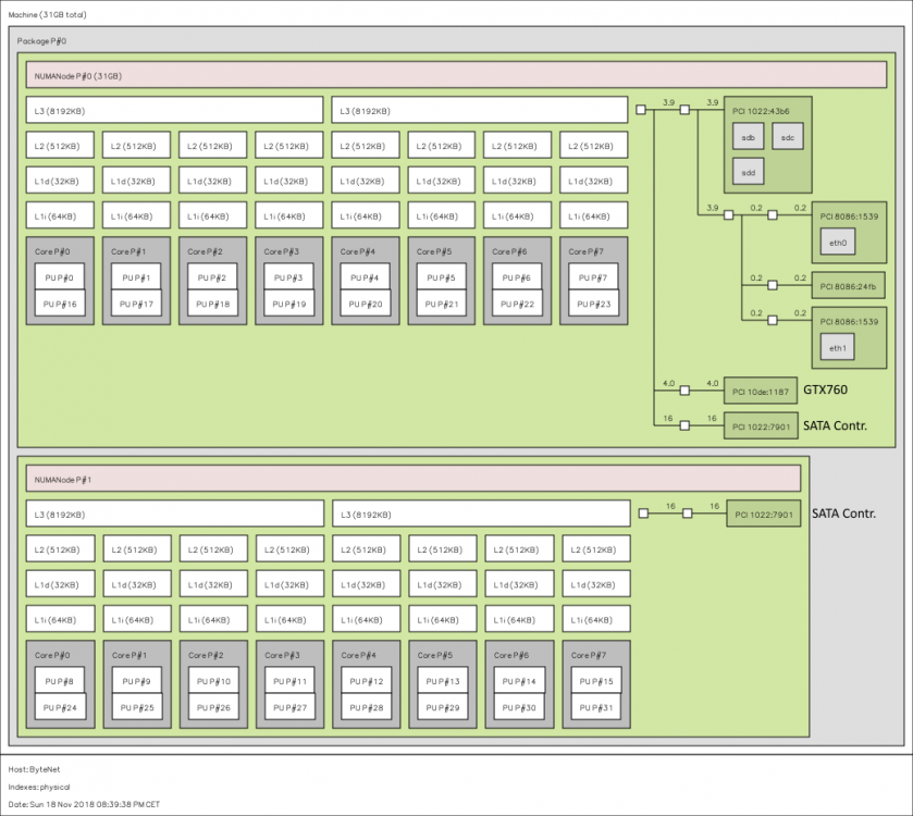

15. get topology png with lstopo /mnt/****/topo_gtx760.png
