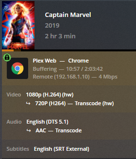

Plex transcoder does appear to see the iGPU device, Plex dashboard shows that a HW transcode session is ongoing, however video keeps buffering and playback is never initiated.
I've checked Plex log quite extensively and they do IMO confirm what I've stated above - the transcoder sees the iGPU, transcode session starts, but there is no video being output.
