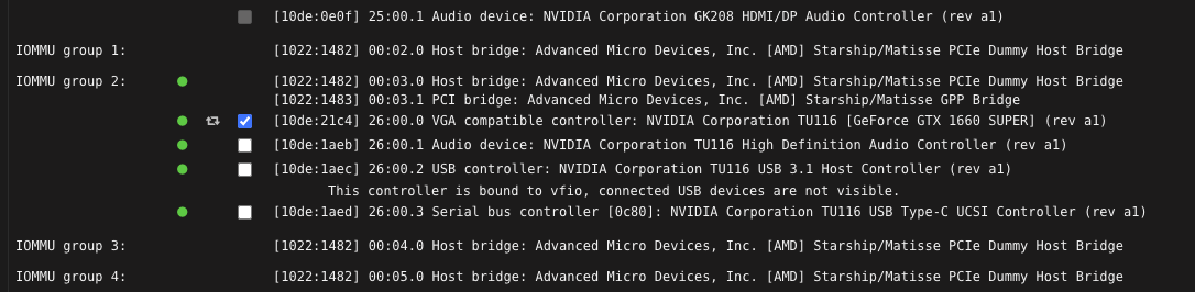

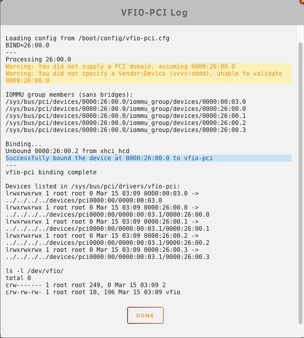

There appears to be an issue with GPU passthrough. I had GPU passthorugh working on 6.9.0-rc2 fine, using the latest approach to vfio binding I could find (using /boot/config/vfio-pci.cfg). For some information about vfio setup, please have a look on the screenshots. Unfortunately, I can not provide much detail on how I setup the VM itself, because it was running for quite some time now and I never touched it.
