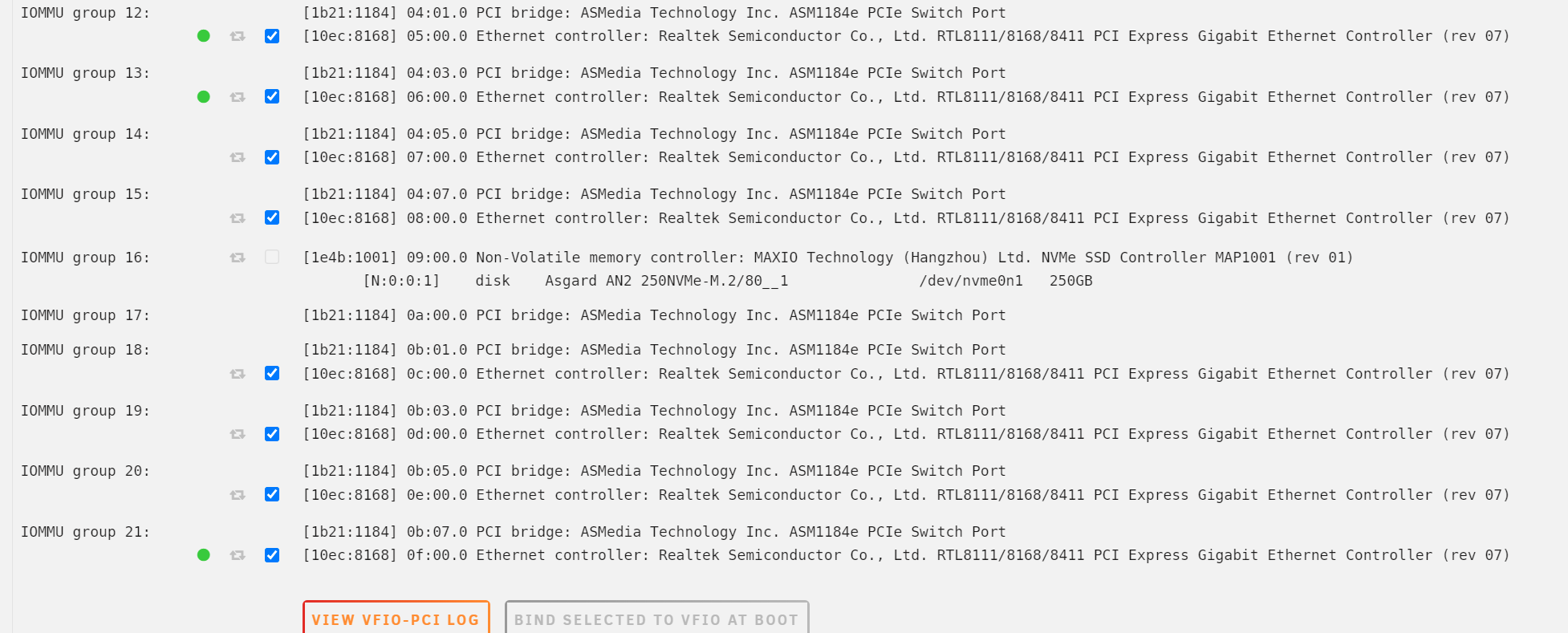

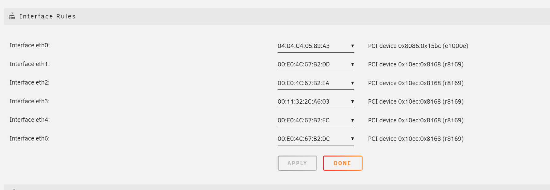

Network card model: rtl8111g (4 network port*2)
In version 6.8.3, the pass through is normal. After updating to 6.9.2, the pass through error occurs. The two network cards can only pass through one and two network ports respectively,After attempting to uninstall the vifo PCI plug-in, cancel the pass through, restart the system(All network cables have been unplugged before straight through), and then restart the pass through, the problem still cannot be solved

Screenshot_3.thumb.png.d97022aceef3d280bc139a310e1b5772.pngScreenshot_2.thumb.png.a40d9bbc3c2923f5f29075d8e4edb00c.png
