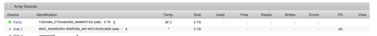

I'm quite new to unraid and after changing case  My dashboard showed me that my main data disk was invalid. I wen to the command line and ran:

I uploaded a screenshot of the grey Icon

Ok thanks
I ran it on the md device in maintenance mode, but I still get the grey icon.
What do you think I should do next ?
Thanks a lot i'm quite lost at the moment.
Because If I mount /dev/md1 I can access the data and everything,
so my disk seems fine
Finally I decided to "Trust my array"
Parity is rebuilding and my data seems fine.
