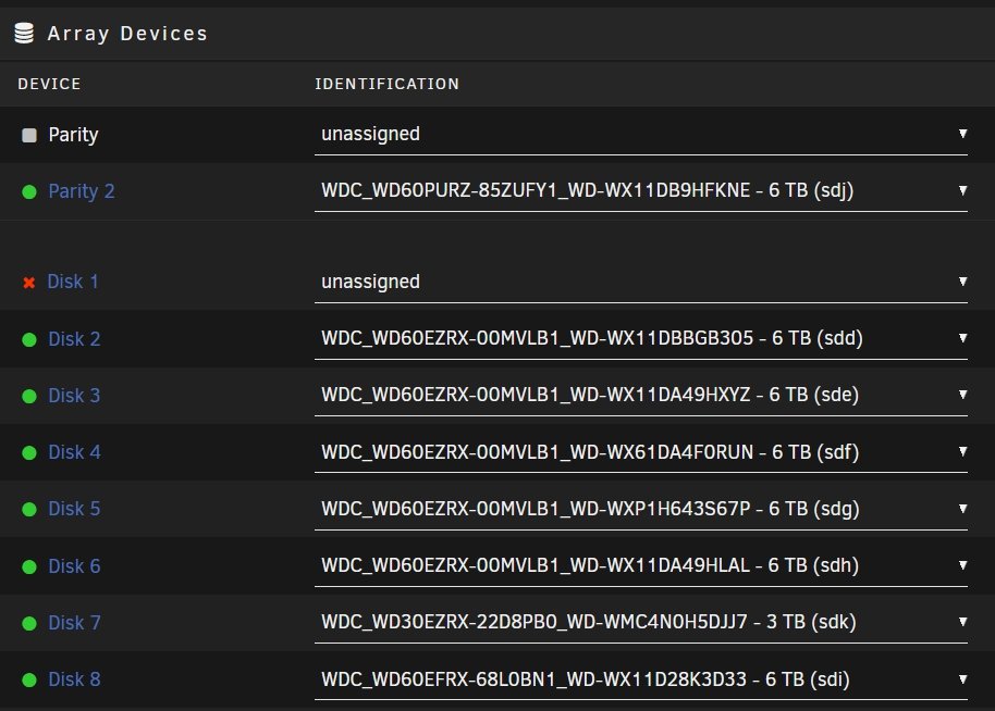

  4. It isn't in the array, it is in unassigned devices (previous disk 2). It is Dev 1, and Dev 2 is faulty disk that would not rebuild parity. Both out of the array.
  5. Actually three disks, then two. First run to see shares without parity. All There. Then with parity disk in slot parity 1, not 2 . Disk 2 was empty, so now it will be backup. I will run preclear on it later, not to bottleneck rebuild. Thank you again.
  6. Thank you, we solved it. I check marked "Preserve current assignments: Pool slots." I mixed what it means pool slots with array slots. I thought it would preserve only cache pools.

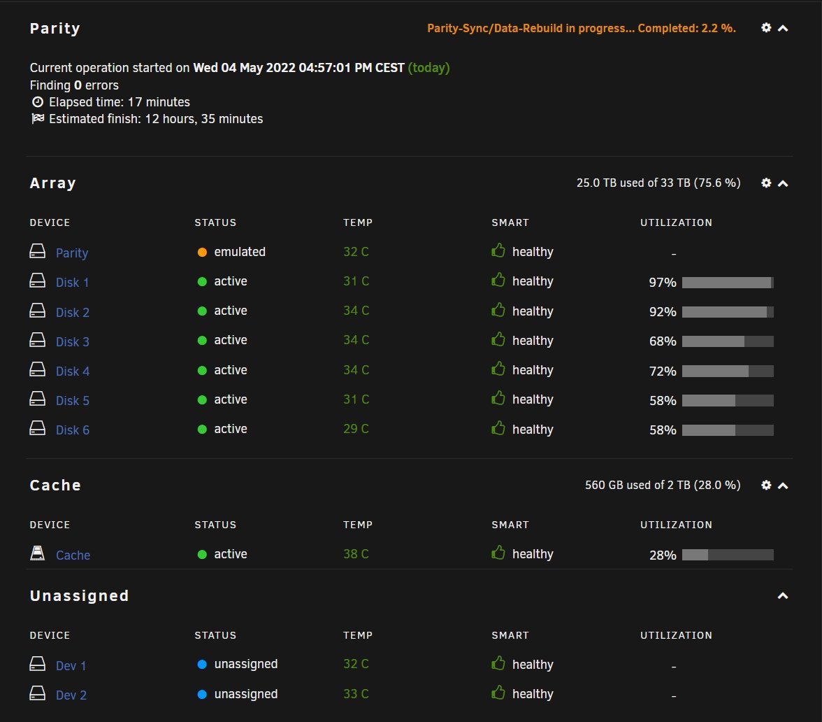

  7. Ok I see you need more context. I want to shrink array because i now have four WD6TB disks fail after 2 years. I have old green wd disks no problems. But new purple and reds are a disaster. I RMA disks back and fourth few times, and I get stuck with them not working. Last time was like this: I go new config but it says "Too many wrong and/or missing disks!" diskstation-diagnostics-20220504-1542.zip
  8. Disk 1 has failed, and with unBalance I have transfered all the data off the emulated disk. Now I don't want to rebuild parity. How do i do that?
