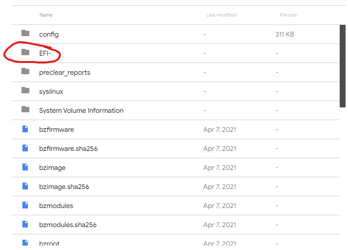

  4. I downloaded the ######-flash-backup-20220708-####.zip before powering off the server and attempted to install it using the Unraid USB Flash Creator but have thus far been unable to get the server to boot to the replacement flash drive created. I plan to have a few other USBs to try tomorrow, it's getting difficult to source a USB 2.0 at this point. Would it make sense to try use the USB Flash Creator to create a clean install of Unraid 6.9.2 and then delete/replace the existing config file with the one from the backup? I ran out of time today, but noticed that there's a EFI folder in the backup. Maybe I need to check the option for UEFI booting when creating the new USB?
