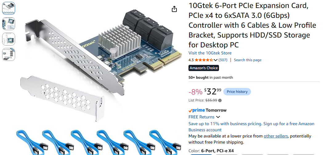

  1. I've got this coming tomorrow (Sunday). I'll let you know what happens. Weird that you can have a stable configuration for months, and then it screws up.
  2. So earlier this month my second parity drive fell out of sync. I tried three times to resync it, it failed every time. I tried Pre-clean and it also failed. So that 14TB has probably bit the dust. About a week later, drive 6, an 8TB, also fell out of sync. When I tried to resync it, it got to about 11%, and the rate dropped to several BYTES per second. I cancelled it, rebooted the server, and tried again. This time it got to 4.3%, and has been stuck there for quite some time. It expects to be done in 18 years, which I guess is better than the 1,000 years last time. It is currently working at 9-15KB/sec. So I am sitting here with NO wiggle room, one more issue and I'm toast, I assume that because I was rebuilding Disk 6 it is worthless at this point for recovery. Any advice on why my server is slowing down during rebuild (I'm running Minecraft on Crafty-4 and it has not had any issues) kaokulk-diagnostics-20260710-2353.zip
