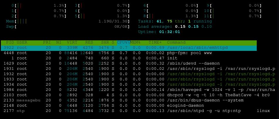

  4. I updated the BIOS to the newest version. Went back over settings to ensure C-State was off, Power Supply Idle was on Typical Current Idle and XMP was turned off. I seem to now have even more instability. Crashed once during a Parity check, roughly 3.5 hours in, and then a second time with no Parity check going. Due to the first crash not giving any syslogs, I kept my desktop going, with htop and log open. Attached is a screencap of htop, once again, no syslog was created during the crash.
