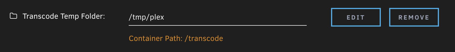

  1. Maybe, but I have plex scheduled to run tasks at 06:00, while the error occurred earlier at 04:47. Apparently my friend was in a watch together with another friend, and looking at tautulli, there were 4-5 people total watching at the time. Honestly, I've had more simultaneous streams before, so I doubt the number of streams was the issue. However, I just remembered I do have ram transcoding enabled, so that could the cause.
