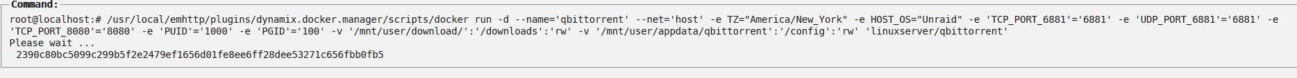

  5. I've been having issues with write permissions. qBittorrent has been able successfully receive files from Radarr/Sonarr, however it will never start a download. Logs confirm permission denied. Deluge works and has the exact same volume mapping. I have tried the following steps with no success: 1. Used default PUID/PGID 2. Used PUID/PGID that successfully work with Deluge (exact same path as Deluge) 3. Used the 'id (user)' command and input the PUID/PGID (values shown in screenshot) Regardless of what values I use, it will not write.
