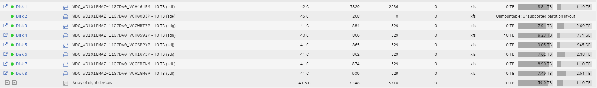

  9. Thanks You! I was able to restore the partition using testdisk. Now the array sees the drive as mountable. All the data was placed into lost+found, when I ran the xfs_repair, so now I need to figure out how to sort through all of that if possible, but it's still a win. I appreciate all the help with this!

  12. I did try it with the partition number but I received the following error /dev/sde1: No such file or directory fatal error -- couldn't initialize XFS library /dev/sde1: No such file or directory fatal error -- couldn't initialize XFS library I'll re-run the GUI and post that command and output.
  13. This is the command I am currently running from the command line xfs_repair /dev/sde . Should I kill that command and re-run the GUI then post that command and output?
  14. Yeah, that was my last run, which I used the -n option to see if it found any other errors. I did one pass with the -n switch, then a second pass without no switches, that looked like it found a backup superblock, and took a little while to run. After that I stopped the array, restarted the arry in normal mode, and it was still unmountable. I then went back and ran xfs_repair from the GUI with the -n switch to see if there were other errors. That is the output I posted. I did stop the array and restart it in normal mode, but the disk was still unmountable. I even restarted the server and started the array in normal mode, but same unmountable state. I started running the xfs_repair on the command line and it found the bad superblock again. The command line is still running, just giving me a bunch of .................. it's been running for about 3 hours now, not sure if it is supposed to go that long, butI want to see if it finishes.
