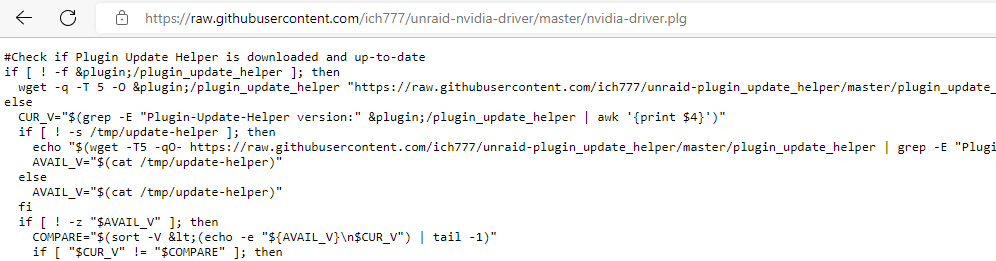

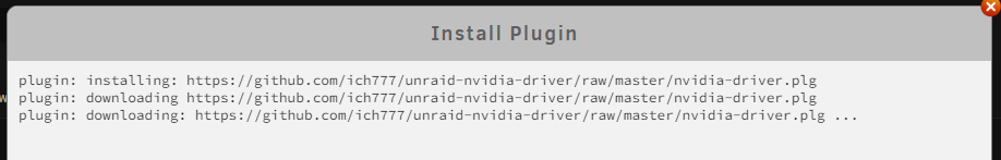

  3. I don't think its your ISP. Nothing changed on my side and I am having the exact same issue starting on around Feb. 15th which I am unable to fix. Everything else works but Plex and its giving no real errors and is running.

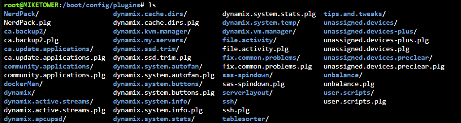

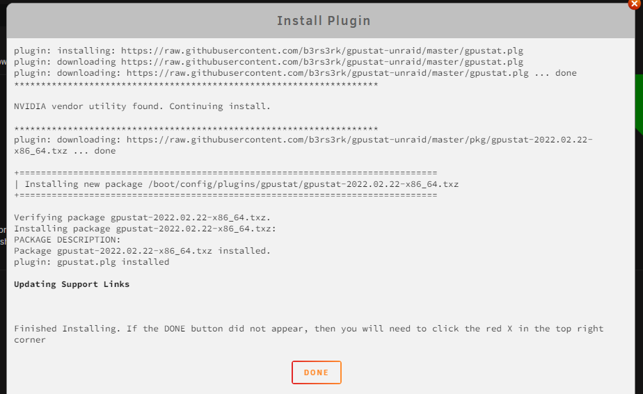

  4. It seems like all plg files are failing to get past the initial step. If I route to that url. EDIT: I left the window open and walked away then upon returning noticed it was just finishing up 20+ minutes later. This is not the internet connection download time. I started the GPUStat plugin install which also took a LONG time to complete. I suspect if I leave the server sit while at boot then in 3-4 hours it would likely complete

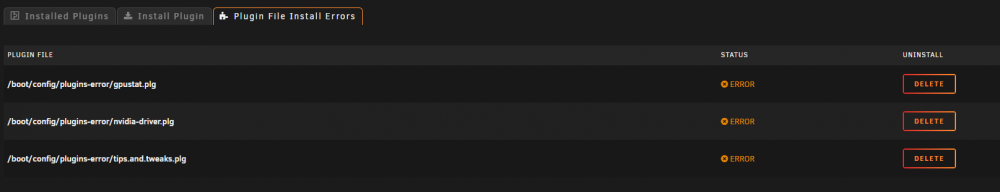

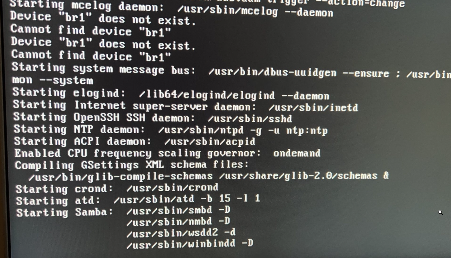

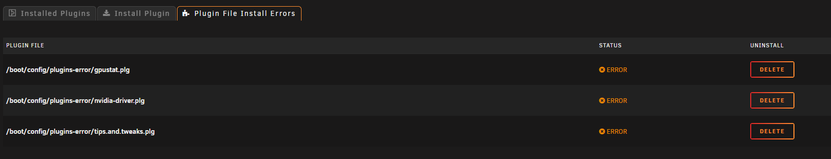

  5. I was unaware of that but is good to know. I was able to delete those via the GUI so it appears to have wiped out those plg files preventing the reinstall. I did do a quick cat on the plg file for user.scripts.plg which is running 2022.08.01 ###2022.08.01 - Use ACE editor (thanks dcflachs) - Update link for cron (thanks Magic-Mayo)
