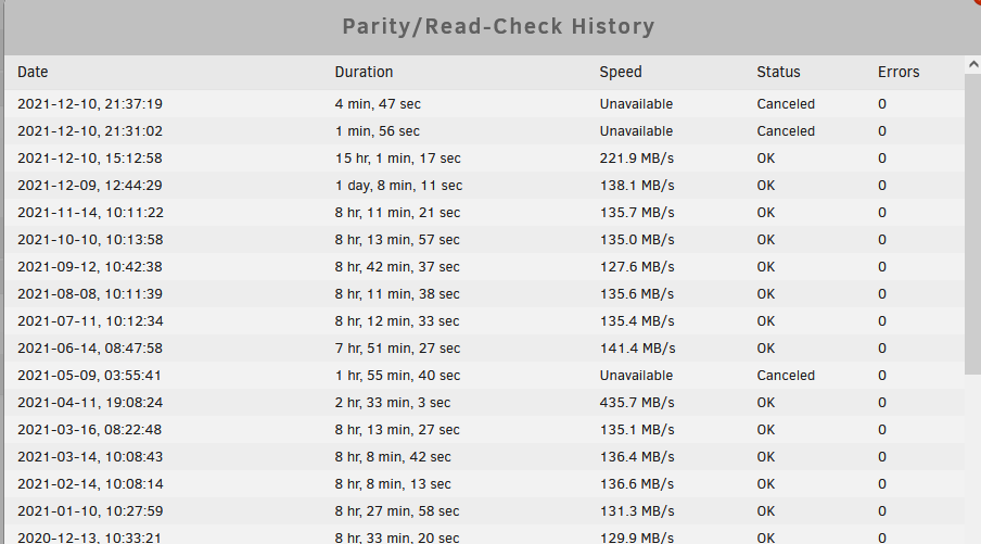

  1. I think I've found the culprit here: root@Kirito:~# dd if=/dev/sdc of=/dev/null bs=4k status=progress 3133599744 bytes (3.1 GB, 2.9 GiB) copied, 16 s, 196 MB/s^C 802639+0 records in 802638+0 records out 3287605248 bytes (3.3 GB, 3.1 GiB) copied, 16.7633 s, 196 MB/s root@Kirito:~# dd if=/dev/sdb of=/dev/null bs=4k status=progress 275914752 bytes (276 MB, 263 MiB) copied, 15 s, 18.8 MB/s^C 67394+0 records in 67393+0 records out 276041728 bytes (276 MB, 263 MiB) copied, 15.1245 s, 18.3 MB/s root@Kirito:~# dd if=/dev/sdd of=/dev/null bs=4k status=progress 4916891648 bytes (4.9 GB, 4.6 GiB) copied, 16 s, 307 MB/s^C 1204285+0 records in 1204284+0 records out 4932747264 bytes (4.9 GB, 4.6 GiB) copied, 16.0833 s, 307 MB/s sdb is my 3TB drive, maybe it's becoming to fail, unsure why now though new diagnotics attached kirito-diagnostics-20211212-0315.zip
  2. @trurl It's been now 24h and my array only managed to rebuild 1.59TB of Parity, despite numerous run at 110/120MB/s the days before I don't see any errors on disk Smart results, cables are the same as before, the parity checks on 12/09 and 12/10 were both on the 12TB drive Only change I had to do was cutting the 3.3V rail to power the 12TB drives, because they refused to boot otherwise
  3. Other models are Western Digital White Label 12TB, freshed shucked from 3 My Book units (identical)
  4. Another useful info: One of the three 12TB drives is performing way faster than the 2 others. I may have it a limitation of my motherboard ? I'll let the parity rebuild on this drive first and get back on why the 2 others are performing way slower
  5. @trurl I've attached diagnostics here kirito-diagnostics-20211210-2120.zip So I can rebuild the drives onto larger ones ? That could work for me, I'll move files back, rebuild the parity and find out how to rebuild on a new drive
