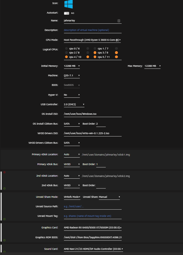

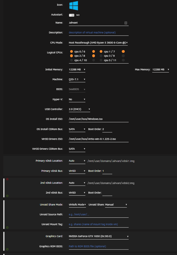

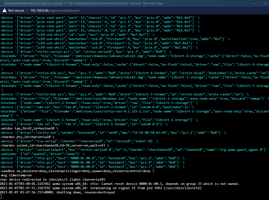

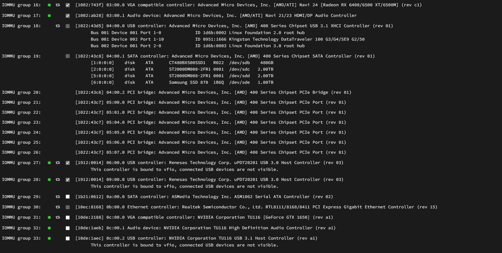

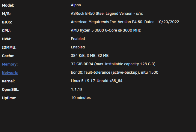

  1. Hello guys, Sorry for being a newbie but I would need some help with my server as the issue i'm having is that unraid is not releasing my gpu when loading into my server for a multiple Gaming VM setup, i look into the logs and it says it can't release the GPU for some unknown reason. Previous i had the same issue but when i used a MSI B450 Tomahawk i was allowed to boot headless and work around this issue. The reason i switch Mobo was due to More PCI lanes i could utilize for my VM's, I have tried multiple different ways including Vfio My GPU's But then the VM Can't use them as they can't be released. I have included Pics and logs Below. My system is: Ryzen 3600 Asrock B450 Steel legend GPU 1: Gigabyte GTX 1650 GPU 2: Sapphire RX 6500 XT 2x 7 USB Controller syslog.txt vfio-pci.txt Jahvani.txt
  2. I have that enable the issue was that in VNC the VM would start up but never work when I made it grab my GTX 1650
