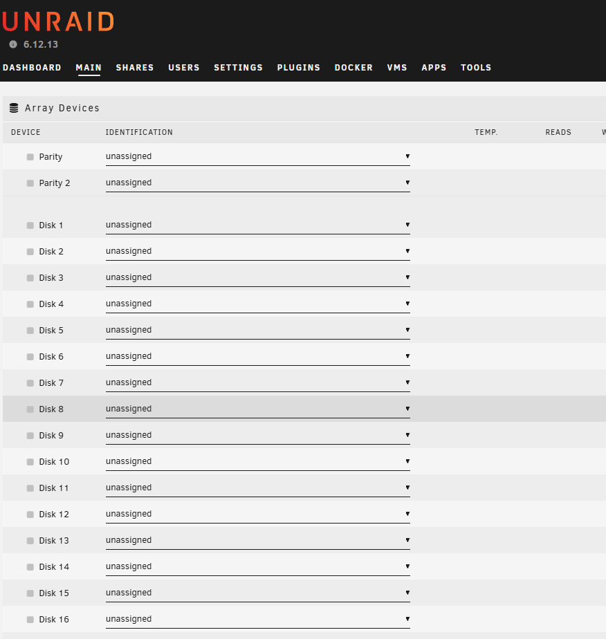

  1. Is this too complicated? I have no idea how to do that, should I just follow the folder structure? also, I removed one of the GPUs and now even the shares are not running... I'm wondering how to not loose all of my shares, the USB has all the configuration inside? whiteserver-diagnostics-20241107-0614.zipwhiteserver-diagnostics-20241107-0614.zip

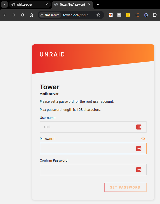

  2. It seems to be running just fine. tower-diagnostics-20241106-1836.zip
