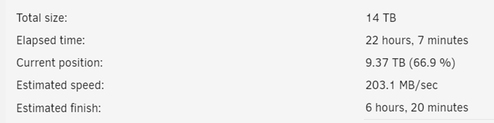

  1. Great news, with the different hardware my parity check finished. Thank you to trurl and JorgeB for giving me great advise on what could be wrong.
  2. Changed my hardware of my server and started the parity check again. The parity check has completed to 9.37 Tb and is at the point where it failed the last two times before. I am hopeful that it passes with the changed hardware. Here is what I am using for my server: ASUSTeK COMPUTER INC. Z97M-PLUS American Megatrends Inc., Version 0330 BIOS dated: Thu 29 May 2014 12:00:00 AM PDT Intel® Core™ i7-4790 CPU @ 3.60GHz Ram: 32 GiB PSU: 1000W I have attached the latest diag file and syslog for everyone's review. 192.168.130.245-diagnostics-20230205-0705.zip syslog_10
