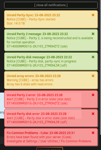

  6. So for a little bit of context I recently flashed a new bios on my motherboard to get it ready for an upgrade I was planning on doing, new cpu and ram. I thought everything was working but after about 6 hours my cpu hard locked up and became unresponsive while transferring some files. I was unable to get any logs of what happened, but after looking at some other forum posts I thought it might be not having reset some of the settings on the motherboard after the bios flash. I have now hopefully set the bios up properly with “power supply idle control” set to “typical current idle” and disabling the C-states globally. I went to run a parity check after it was stable for about a day only to have it completely crash at around 40ish%. I also unfortunately didn’t get the logs for that either. Upon reboot I saw that both my parity drives have been disabled and figured I would just rebuild them. However…. Now when I try to rebuild the drives I am getting “Alert [CUBE] - parity2 in error state (disk dsbl)” and “Alert [CUBE] - parity in error state (disk dsbl)” along with a warning that 6 of my disks have read errors. Any ideas of how to get this fixed and my server back to running normal again? Hopefully saving as much of the data as possible. I will try to be as responsive as I can while at work. I uploaded 2 diagnostics files. one is before the second failed attempt, the other after with the errors. For reference my system is a AMD Ryzen 5 3600 6-Core @ 3600 MHz ASRock B550M Steel Legend American Megatrends International, LLC., Version P2.80 BIOS dated: Fri 05 May 2023 12:00:00 AM MDT with 32gig of ram I am running version 6.11.1 cube-diagnostics-20230823-2351.zip cube-diagnostics-20230823-2318.zip
