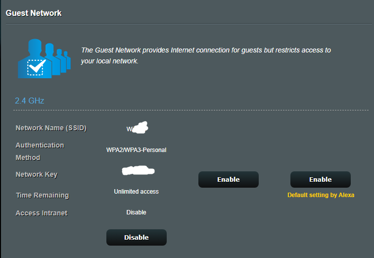

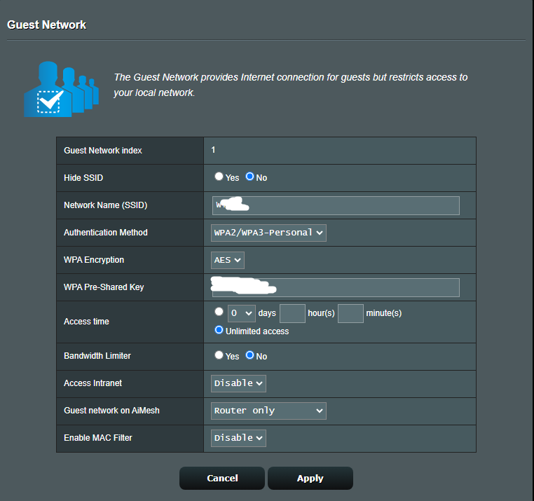

  8. I have (now) but it doesn't really provide any more info, that I can see anyway. I do have the guest network set as a separate SSID and password. However neither the Unraid or my PC is connected via WiFi so I find it rather strange.. If I enable "Access Intranet" it starts working again as well but that kinda defeats the purpose of a guest network imo. I've attached a couple of images below of the guest network setup screens of the router.
