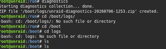

  2. OK, used Mint GUI to connect via SSH and ZIP the directory. Looks like most things are blank to me (e.g. no shares etc). unraid-diagnostics-20260706-1253.zip
  3. Says it created a diagnostic file, but it isn't visible. I have found 3 diagnostic directories created in the root directory. Under /unraid-diagnostics-20260706-1343 I see 7 subfolders and 1 unraid-7.3.1.txt file. Not sure how to turn that into a ZIP file and move it from unRAID to my linux desktop here. No significant changes made at all. No new containers / plugins etc.
  4. Hey all. Looking for some tips here. hoping I haven't been hacked. I run regular updates, and am on the current version of unRAID. However 3 days ago, I was unable to log in. The GUI was completely unresponsive. Couldn't SSH in either - kept getting connection refused. Had to hard power the server down :-( Came up fine though, and everything seemed good. Today, 2 days later, GUI was not working properly. Basically hardly anything being displayed on screen. Again, couldn't SSH in. Accessed terminal from connected keyboard and monitor, logged in and entered "reboot" on cli. Saw an error in /etc/initscript: line 22 /etc/rc.d/rc.6: input/output error. Hard to force power off again for second time in 3 days. unRAID rebooted, I logged in, figured I would check SSH is enabled (it was). Cancelled the Parity Check (as that would take days and had just completed 4 or 5 days ago. Saw there was a plugin update for Tailscale, started it, then saw an error the update was unavailable. Clicked Docker to check for updates, then got thrown out to a First-Time-Boot type of screen. I've been running unRAID Plus for years, and mostly just do updates. But something seems to have gone haywire. Every time I hit "Skip Setup" it just returned to this screen. After 5 minutes, I just tried it again, and the GUI is no longer accessible. [OK - figured out it was using https which is no longer valid, so can see the login screen at http://IP address. BUT, I cannot log in as root, just clears my password and returns to login screen] However I have now been successfully able to SSH in. I've suddenly got lots of questions! What is going wrong and where do I begin to diagnose / fix it? My first concern would be data preservation. How do I stop the array cleanly from an SSH connection? How can I restart the GUI? How can I diagnose what problems there are (e.g. is it my USB flash drive going bad, memory errors)? Has all my config totally disappeared? Extra information - my shares are currently inaccessible. I have a flash drive backup that is approximately 2 months old (from version 7.2.4) although unRAID had been updated to 7.3.1 (if that's what current is). Any help with next steps would be greatly appreciated! Thanks.
